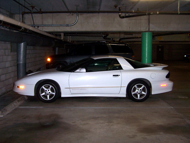

Okay, my 96 Pontiac Trans Am developed an attitude the other day. The power steering went out and it was hard as hell to steer, so I thought the worse, but something strange happened. Two days later I drove the car and power steering was restored, now how weird is that? How can a car repair itself? Is this a symptom of another failure or was it a computer glitch?
Any thoughts?
You may have just had a small piece of crud stick in the pressure bypass valve on the pump. That would have given you basically no pressure to drive the power steering actuator. Most power steering systems have very tight clearances in the valving and rather poor or non existent filtering systems.
It could have just had a an air lock in the pump itself too.
I'm no great expert on American cars, but electric power steering is rare. The only car that I know of with it is the MGF. Electro-hydraulic power steering is more common, but still only on small cars.
I guess that a '96 Pontiac would have power steering completely unaffected by any electrics, let alone electronics. There is likely to be a pump with a pressure relief. That will feed oil to a valve that controls the ram. The movement of the valve is controlled by the torque in on the steering wheel. The valve can feed the oil in either direction, a bit like an H-bridge. It is set to leave all the ports open with no torque, so that the oil flows freely and wastes as little power as possible when no assistance is needed.
Intermittent action sounds like a stuck pump valve or pressure relief valve. I would change the power steering oil and see how dirty the old stuff is. It could also be a flexible hose where the inner has come away and is stopping the flow. You can operate the pressure relief valve by holding the steering hard to one end and revving the engine.
Fiat Punto's have it, and the manual specifically mentions the possibility of overheating and temporarily losing the power assist.
Yes, but Fiat Puntos are a long way from '96 Pontiac. It would surprise me if the Pontiac has electric power steering.
If its hydraulic power steering then your fluid might be getting low or you might have had a slack fanbelt.
Other things that can happen is the alternator seized or stalls which kills the fanbelt causing the power steering to go as well - you tend to notice the noise and burning smell from the belt when this happens.
Thanks for the tips.
Well, just an update on this. This may surprise you but the problem was my water pump. It was freezing up and was causing the drive belt to screw up which in turn was messing up my power steering. I guess the engine always running very hot and a battery charge problem should have been a clue. With the new pump, my car starts right up, runs, steers, smooth and cool :)

Thats a nice Trans AM, whats it have under the hood? It must be nice to be able to drive it year-round. I have a 86 Monte Carlo SS that has to sit in storage for the winter. I built a 400+HP 383 Stroker, so I couldn't afford to drive it year round. I'm happy when I get double-digit miles per gallon.
Mine has a 5.7 Liter. 350cc engine. I have to put the car on ramps to do just about anything. Changing the spark plugs has my cursing for hours.
