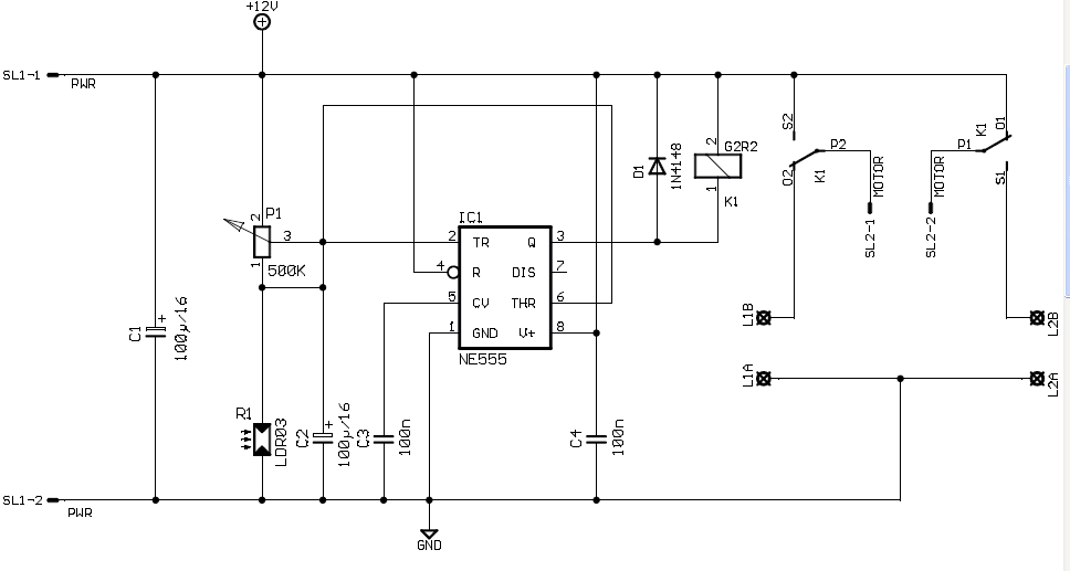

I have been trying to make a self-drawing curtain system, to draw the curtain’s in my flat for me when I am not there, kind of a burglar deterrent, so it looks as though someone is living there. Also it would be a really cool feature… But… when I came to actually put the thing together in my head and on paper, I find that I am ok with the mechanical side of thing’s but actually wiring the thing-up is baffling me. I realise that I am going to need relay’s etc… or would I need more!… really it is beyond me,:confused:... so I had this bright idea of asking you guy’s for help… What do you recon, anyone got any idea of how to go about it, making it as simple and safe as possible of course?
Basically I want the curtains to draw themselves automatically when it gets light in the morning and then draw themselves closed again at night.
I was intending to use two 12 Volt car window winder motor’s with gearbox (Built-in), as they seem to run very nicely and at a good speed, to do the actual drawing of the curtain’s, with a couple of micro switches on the rail, to signal when the curtain’s are either fully open or closed, as well as of course a magic eye, to indicate when it is getting light or dark. There would have to be some safeguard against jamming and overheating etc. Wouldn’t want to come home to find the fire brigade rescuing me neighbour above!
Although I mention using 12-V car window winder motor, I would like the device to be run from the household power supply.

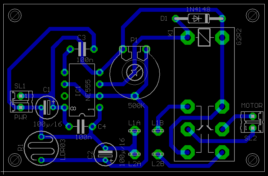

Here is an adjustable (for slow reaction) 12VDC dawn switch controlling a relay which drives the motor.
The circuit requires limit switches (NC) for the open and closed position of the curtain, to be connected to solder pads L1A - L1B and L2A - L2B which interrupt ground connection to the motor when the limit is reached.
The board is single sided and measures 57X37mm (2.24X1.44").

OK, lets take a look at the schematic:
As long as there is sufficient brightness the DPDT relay is not engergized meaning current flows via O1 - P1 (+12V) and O2 - P2 (ground) via the motor. If the motor reaches final position the connected limit switch between L1A and L1B should interrupt current flow. If dawn occurs the switching sequence is reversed powering the motor via S2 - P2 (+12V) and S1 - P1 (ground). Here again the current flow must be interrupted by the limit switch connected to L2A and L2B.

A rectifier will rectify mains voltage to 323VDC if mains voltage is 230VAC and to 160VDC if mains voltage is 115VAC.
You need a suitable transformer (15V secondary voltage, capable to supply enough current for the window motor (I guess somewhere around 5A), a rectifier and a smoothing capacitor and a linear regulator (LM317T with current boosting transistor) to make a reasonable DC-power supply.

Slow reaction is necessary in order not to have the curtain move if a passing cloud reduces light conditions temporarily.

the circuit requires adjustment with the 500K pot to determine brightness and darkness.
You might try out the function by taking the pot to center position and shading the LDR completely which should cause the motor to turn in one direction. Exposing the LDR to light the motor should reverse.
If that works alright you should wait for real conditions (dusk or dawn) to switch the motor accordingly by turning the pot to the desired direction and position for the desired action.
For quick reaction short the electrolytic capacitor C2 (100µF) or simply omit it for testing.

as a good method to find out the approximate trip point of the circuit I recommend measuring the dark/light resistance of the LDR you are using. The light resistance should be in the range of 5 to 15KΩ and the dark resistance several 100KΩ.
For a functional check short out the LDR to trigger the timer IC.
C3 may be reduced to 10nF.

well I smoked it. shorted out the ldr and motor reversed but then puff of smoke. woops well I guess I'l start from scratch. I will make this work.
Hi tuke,
although you smoked it you know by now that the circuit works. You should check the output pin (3) for shorts (both to V+ and to ground).
Another possibility is too much current flow through the relay you used. Automotive relays have a very low coil resistance which might have caused more than 250mA frying the chip.
I also recommend to check the relay terminals for proper wiring. If the relay shorts the supply voltage you will also smoke your power supply.

I would strongly recommend a transistor driving that relay. Even if the relays coil resistance is fairly high, the 555's 250mA output is an absolute limit.

modern relays (even power relays) draw a maximum of 40 to 60mA. So there is a fairly good safety margin for the timer IC.
There are four solder pads contained in the schematic (and also on the PCB layout). They are named L1A - L1B and L2A - L2B. Those solder pads should be connected to limit switches (NC) to open when the motor is supposed to stop.

Ok, finally received my new shipment of parts. Built another curcuit and it works like a champ. Now all I have to do is install it for the real test. Thanks Boncuk for all the help.
