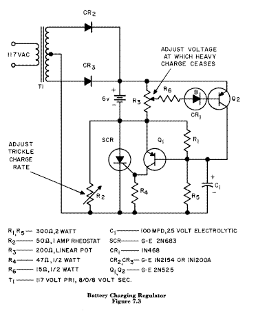

I am looking for it since one month. But i couldnt find yet
How can i do it ? Do you have this circuit ?
Hi Minnik,
I didn't have to look for it so long to find it but it's probably not
the right one, but here it is.
For charging a 12 volt battery, a 300 ohm 1 watt resistor should
be inserted in the collector of Q2, R3 should be increased to 400
ohms and the secondary voltage of T1 should be doubled.
on1aag.

Mr.Gayan Soyza;
its a homework about SCR.
its unimportant what batteries.
the circuit must have SCR.
if you have a simple circuit batery charger with scr. may you give it to me.

You looked for a month and it is a homework problem? Isn't it _way_ past due? Why won't you work it out yourself anyhow?
because. i colud't do it. i tried in ewb and isis for it. and after i started to looking for.
