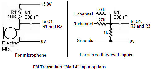

i found a solution by you (AGAIN!:p) which mixes and attenuates the source from an audio output of a computer into the FM transmitter.
3 resistors mix stereo into mono and attenuates the result.

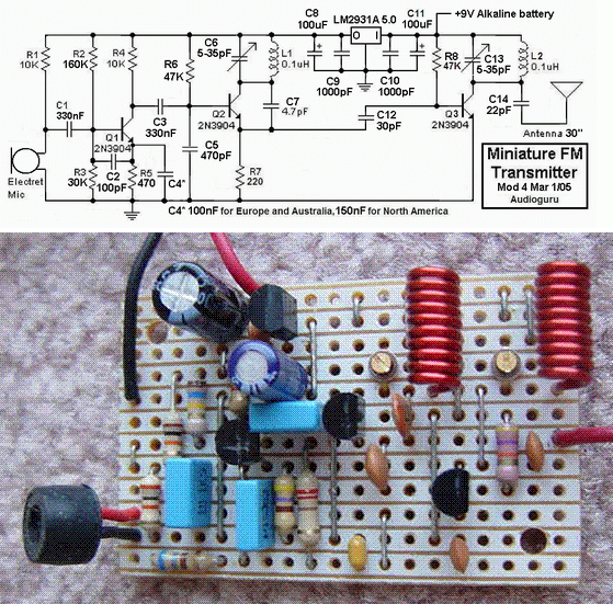

Here is my transmitter again:
hi audio guru,
Thank you so much for explaining and even showing us the input options, regarding the stereo to mono conversion, why do we need to attenuate after mixing the stereo signal into mono? btw, is the circuit above the final version?Again, many thanx for posting the schematics again!
The mic preamp transistor has a very high sensitivity of about 5mV but the output of an ipod is about 27 times higher.

hi audio guru,
THanx for explaining on the mic preamp transistor part...just one more thing, is the oscillator used (transistor Q2 part) a colpitts oscillator? how did you calculate that part? did you use the formula Fout=1/2*pi*sqrt(LC) ?
Yes, Q2 is one version of a Colpitts oscillator.
I used the same oscillator parts that hundreds of other FM transmitters use.
The frequency is so high that you cannot calculate the tuning inductance and tuning capacitance due to unknown stray inductance and stray capacitance of the wiring.
I use your formula to calculate parts for a speaker crossover filter that works at low audio frequencies, not high radio frequencies.

hi audio guru,
From your original circuit, what does the capacitor C2 does? i can recognise the common emitter configuration but can't seem to figure out the capacitor C2 which shorts base to emitter...btw, what does the whole part do? pre emphasis?how does it work? if yes can i replace it with a simple high pass filter such as LC combination? thanx in advance!
