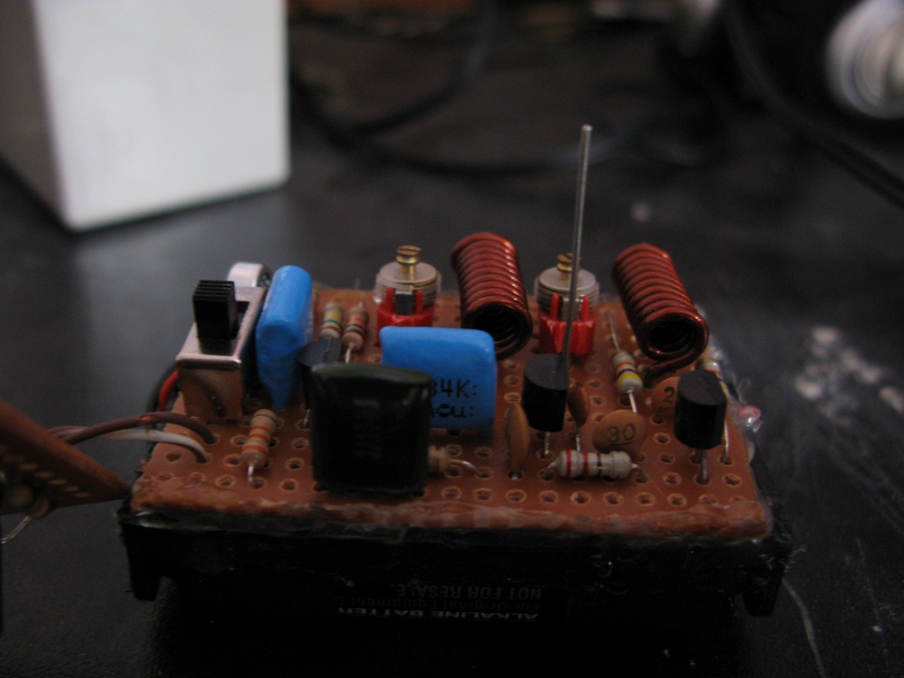

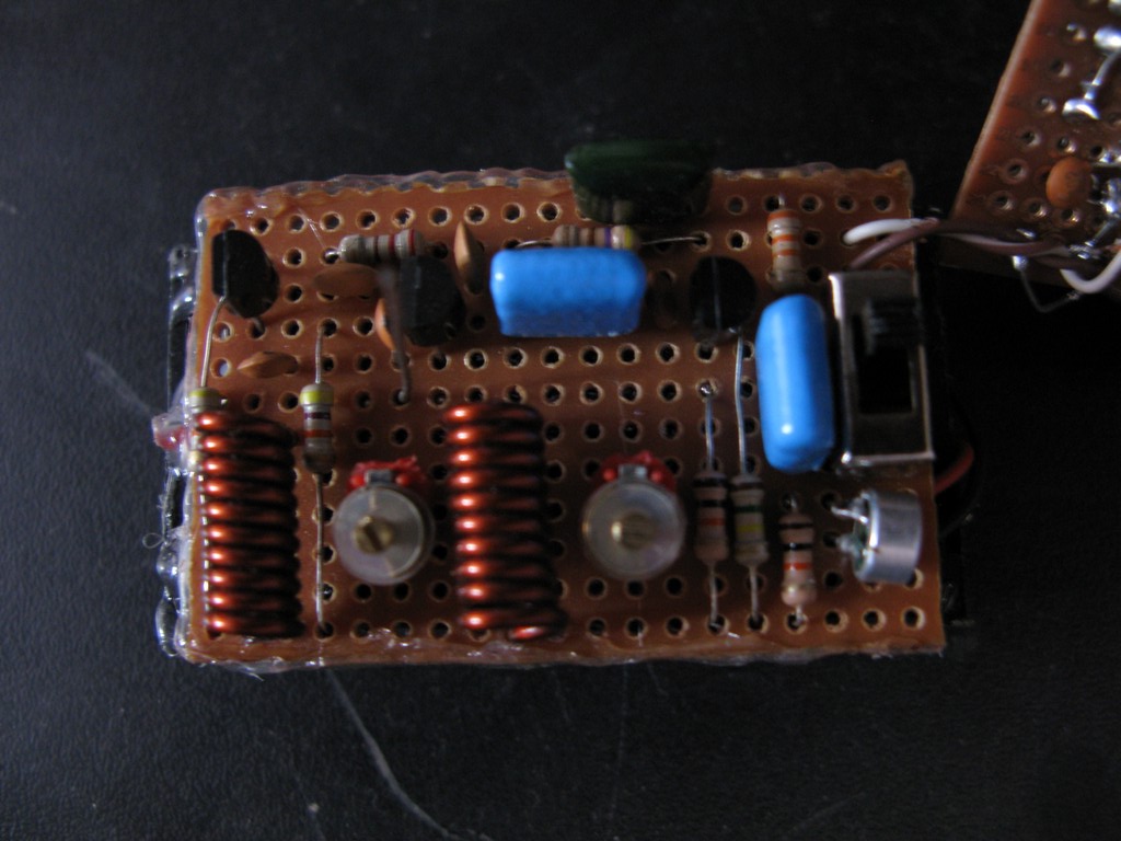

Thank you Audioguru! I made 2 quantity of your MOD4. One with regulator, which cost a lot here in Pakistan about 75 rupees, or equal to 90US Pennies.... it works perfect with mic.
90 US pennies is cheap for Canadians. It is almost the same as one litre of gasoline.

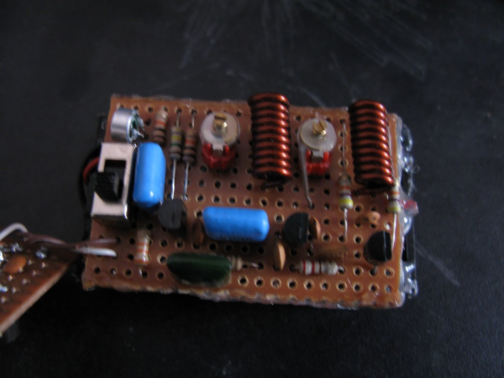

Another one I made without regulator, because it's too expensive, but I can't get audio from mic.
I designed the biasing of Q1 the mic preamp for a regulated 4.75V to 5.25V supply. If the voltage is lower then Q1 is cutoff and if the voltage is higher then Q1 is saturated. it is also very important for Q2 the FM oscillator to have a regulated supply so that the frequency does not change as the battery voltage runs down.
Can you please recommend any suggestion about my second unregulated transmitter! I'm operating it on 3 volt DC, 2 AA Cells......
My transmitter was designed for a 9V battery and a 5V low-dropout regulator. You can re-design it for 3V (that drops to 2V) if you want.
I can also buy a litter of gas here in PK about 68 Rupees, lol.... But I don't know what things can be changed to re-design it for 3 volt AA cells.....
And can i power up my first regulated transmitter to a 12 volt car battery? it's has a 3 volt deference compared to a 9 volt battery...
I'm sorry, I forgot to let you know that I couldn't find "R2-160K" I put 150K resistor and "R3-30K" I put a 33K resistor.... Do you think it's the problem which is causing Mic stage not to work?
Okay, I just removed Regulator from my first perfect transmitter and installed its connection to my second transmitter, and supplied the 6 volt DC power, it's working magically, and sound quality is good too, and has a good sensitivity, I can hear it on other room clearly.......
I understand that your circuit need 5 volt regulated supply, but I will be using this transmitter for a 2.4 volt rechargeable AA Cells. Would you please let me know what regulator do I need to regulate it at 1.8 volt dc, and what parts needs to be changed in transmitter? Thank you....

Changing the voltage also changes the currents. Then nearly every resistor will need to be re-calculated and its value changed.
Like you said before, then maybe Q3 will get too hot. Also, maybe the 5V regulator will get too hot but it can be replaced with an ordinary 7805.
Yes.
I designed my FM transmitter for The West where ordinary 160k and 30k 5% resistors are available everywhere. Yuor transistor is saturated with its collector voltage as low as it can go and it will amplify loud sounds with extreme distortion.
Of course, that is the way it was designed.
Then you need a low-dropout 1.8V regulator but I don't know one.
Nearly all resistors will need to be re-calculated and replaced with the new values. I will not do it.
The range will be low and the audio will probably be distorted most of the time with such a low supply voltage.

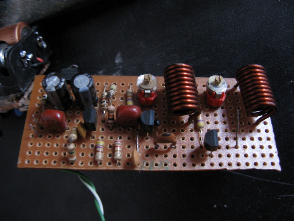

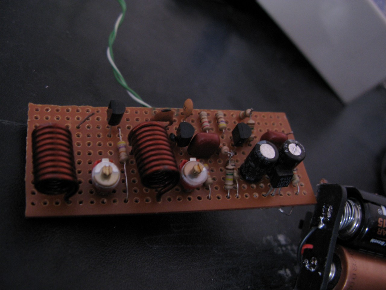

Audioguru, looks like it's a complete copy of your FM transmitter, but it's designed to work at 3 volt DC.
I'm eager to know should I put a coil and a trimmer at the RF output stage, and remove the 330R resistor?
It is completely different:
1) Its output power is low so its range is only as far as you can talk.
2) Its oscillator does not have a voltage regulator so the radio frequency changes as the battery voltage runs down.
3) It does not have pre-emphasis (treble boost which is the opposite of the de-emphasis [treble cut] in all FM radios) so it will sound muffled. In fact, the 1nF capacitor at the base of the oscillator transistor cuts high audio frequencies instead of boosting them.
The 150k base resistor results in a low current which makes low output power. Reduce its value to 15k or 16k and add the coil and capacitor.
