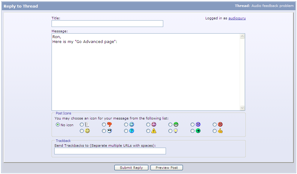

Ron,
Here is my "Go Advanced page":
Ron,
If you want to see and use the smileys, go to User CP in the bar near the top of the page.
On the left side, click Edit Options.
Go to the very bottom of the page, and select Enhanced Interface - Full WYSIWYG Editing.
