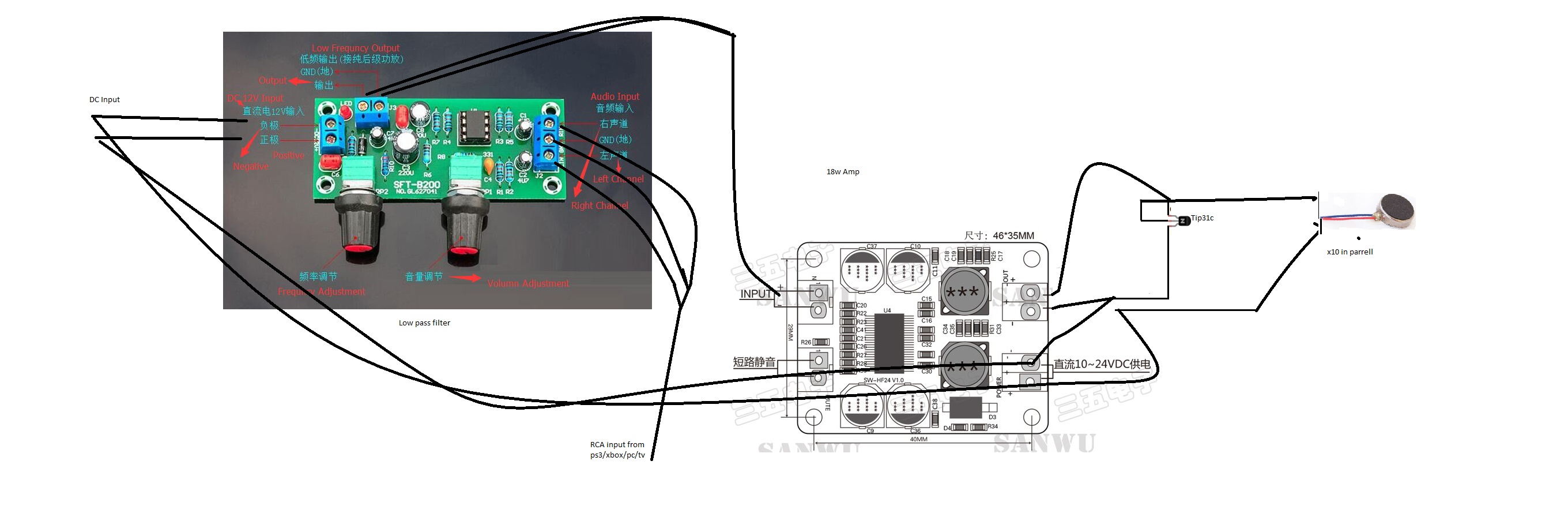

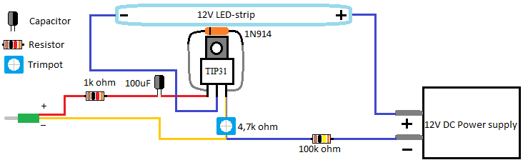

Hello from sunny New Zealand. My name is bianca and im really into gaming in a huge way. I want to build for a science project a vibration vest using a TIP 31 and an audio input. The circuit i found on various websites was for LED but i want to replace them with 10mm coin vibration motors. I am looking at running a 9-12v DC input and 10-12 little 10mm vibration 3v 60ma motors.
I would appricate any help.

I would like all the motors to respond at the same time off 1 or 2 controllers. I am going to run a low pass filter so they only respond to bass of the game.
I was going to use a 18w aliexpress D class amp to boost the signal from rca/audio jack that comes from the playstation/pc.

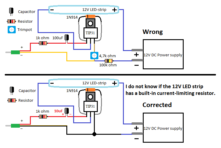

You copied the defective circuit. I fixed it a few years ago but it blinks an LED strip and probably will not run motors.
As I said in your "conversation", since you have an audio power amplifier then you do not need the power transistor circuit.
1) The input to the amplifier must have a lowpass filter.
2) The output of the amplifier must have a rectifier and probably needs a peak detector circuit so that the output has a long enough duration for the vibration motors to start running.
3) Instead of only one or two motors you will drive 10 or 12 of them? If your amplifier has a real output of more than 2 Watts into 8 ohms then it can do it.
4) Two resistors will convert stereo into mono.
Here is the LED circuit I corrected:
A minute ago I answered exactly the same post in your "conversation". The duplication is a nuisance.
Your diagram is new. It shows an audio amplifier and a TIP31 transistor connected so that they blow up each other. The amplifier is probably bridged (an amplifier for each speaker wire) and you are shorting its (-) amplifier to the power supply. There is no output rectifier so the motor will try to go backwards and forwards so fast that it will just sit there and fry.
