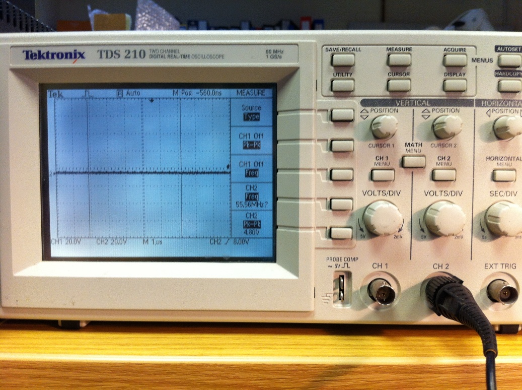

- Pic1 shows the oscilloscope reading from the collector of Q2 with the holed piezo (ignore the reading of 4.8V, its just a slight ripple that is being picked up)

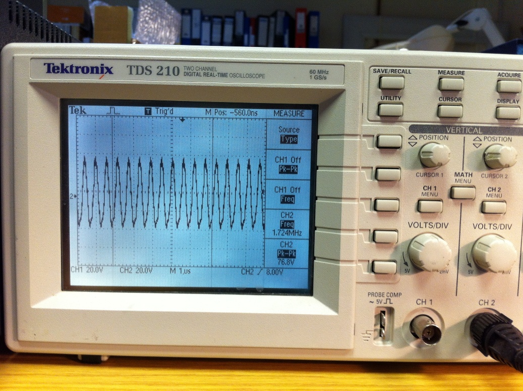

- Pic2 shows the oscilloscope reading from the collector of Q2 with the non-holed piezo

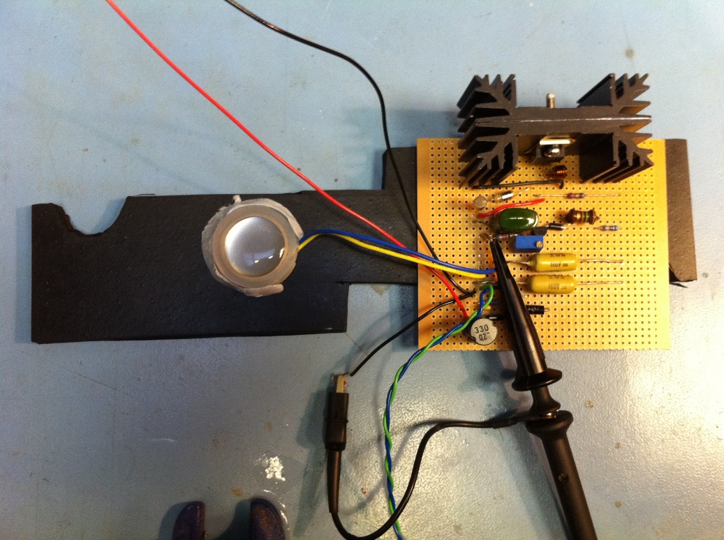

- Pic3 shows my circuit (with non-holed piezo hooked up)

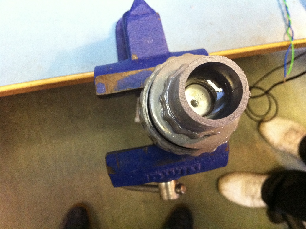

- Pic4 shows the chamber with the holed piezo in it (you can just see the hole through the water)

Does your power supply have an overload trip? If Q2 stops oscillating (perhaps because of damping by the epoxy/glass) while Q1 is 'on' then the standing Q2 current will be excessive and drop the supply volts.
Have you tried the holed piezo in circuit without the sig gen and with J3/J4 shorted?
Even if the circuit won't self-resonate, it can easily be converted into a driver that you can use with your frequency generator to force some sort of vibration out of that holed transducer. You are almost there, you just need to trace the signal through the circuit.
Ok, ive now tried reading the oscilloscope using DC coupling and i get 24V DC at the collector of Q2 with the holed piezo.
I think youre right about the transducer stopping oscillating due to the glass, and i think that as a result Q2 is on constantly because my power supply is reading 400mA being drawn by the circuit. Q2 is certainly getting hot when using the holed piezo so i can only imagine that this 400mA is probably going via the collector->emitter->L3 path where the reactance of L3 is the only thing preventing a short to ground.
I think that possibly the conclusion is that the piezo wont naturally resonate in this circuit whilst it has a hole in it, and that the only reason it responded during the frequency sweep is because it was being forced to, rather than (to use your analogy in a previous post) it being struck like a bell and left to resonate on its own?

Yes i have, the readings that ive just described are with the holed piezo in place with J3 and J4 shorted. With a normal piezo in place the collector of Q2 bounces up and down nicely as in pic2 in my previous post.
If you've only got 45mm water pressure the glass plug is a bit OTT. If you could remove it and instead use a thin clear plastic or glass cover (microscope cover glass?) over the hole, on one face of the piezo, there would be much less mechanical damping. Assuming the piezo is being driven in thickness mode (rather than in a flexure mode), the plug is presently acting like a clamp to prevent vibration of the piezo. With the plug gone it might then be able to oscillate freely.

Right, just an update on this, ive got the circuit working with a holed piezo now. As i thought, the circuit was working the whole time because i was getting a mist form when i used an unholed one, but it turns out that the holed one was fubar'd all along which was why i couldnt get it ringing on its own.
Our customer has now said that the hole doesnt need to be as big as 5mm :rolleyes: so i got our mechanical guys to drill a 2mm hole instead, which works just fine in my circuit.
