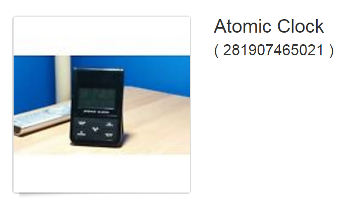

I got this one in 2016:
eBay at $5.00 It is accurate to within a second compared to NIST time. PC time (Internet time?) as I write this is about 2 seconds faster. It just sits in a first floor window and hasn't been touched. Seller was "coolproducts4u15" but he has not been active recently. No brand on the clock. Dimensions are roughly 72 mm X 107 mm X 16 mm.
There are so many offerings that purchase is probably a hit or miss proposition. My criteria were good looks, size, and cost.
