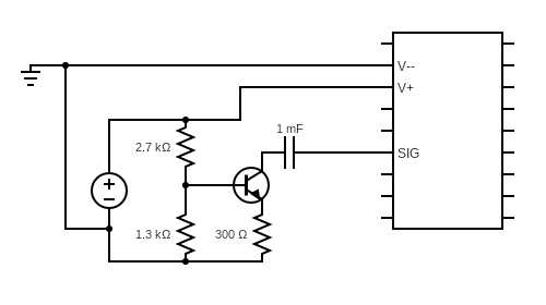

Hello everyone! I'm new to electronics, I've have only had a circuits 1 course (I'm ME so that's all I'll get), and I want to see if this would work.
I'm trying to make an in-line board between my brake light switch and my brake light on my bike so that when the brake is pressed the light will flash a couple times, then stay on until released. I plan on using a LM3914 driver that switches power to pins based on a signal voltage and a capacitor between the 12v input from the brake switch to the signal pin. I know this would work but I want the rate between flashes to be constant so the capacitor needs to be charged with a constant current source. After a bit of searching found a basic way of using a transistor (2n2222) to create a constant current source but using it this way is different than the example circuit I saw. Am I on the right track?

Your transistor in the first post does not charge the capacitor because it is not a current "source". Instead it is a current "sink".
The capacitor does not pass DC anyway so if you fed the capacitor from a current source then the output of the capacitor into the SIG pin would produce only one pulse. Constant DC current into a grounded capacitor would produce the rising voltage you want.

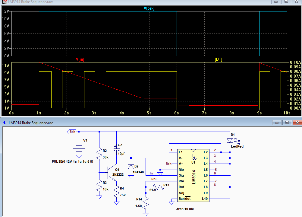

Here's the LTspice simulation of an LM3914 circuit similar to what you proposed.
The capacitor is connected to the 12V so a grounded NPN constant-current transistor could be used to charge the capacitor from 12V towards ground.
This means the pulse sequence starts from LED 10 and goes down.
The discharge (and thus the pulse) rate can be changed by varying R4.
The LED current is controlled by the values of R13 and R14 (higher values gives a lower current).
The values should be changed in the same proportion if you want to change the LED current (100mA maximum LED current).
Edit: Opps, I see an error, back to the drawing board.
Edit 2: Okay, corrected.
Edit 3: Double opps. Corrected D2 capacitor discharge diode location.
Wow, just got on after last night. Thank you all for the help, and thank you crustchow for that schematic!
So I did a simple calc to adjust R4 for the desired rate, the 0.6 is what I was the told the voltage drop would be through the transistor. It seems to line up to your graph. But hey, I thought my first circuit would work.

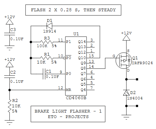

Here is a first pass at a circuit based on the CD4060. R2-C2 reset the counter each time power is applied. R1-C1 set the oscillator frequency, which is divided by 256 for a calculated output pulse width of 0.28 seconds. The output flashes twice than remains steady on until power is removed. Adjust R1 to change the pulse width.
There probably is no need for a power MOSFET as big as the one in the schematic; I just grabbed one in my library.
Rather than drive a relay that drives the light, it is better to have a power MOSFET drive the light directly. Is the "other end" of the light (the end not driven by the switch) connected to Vbat or GND? Depending on the answer, the output stage might change.
Update - corrected schematic with correct times, all 5% resistors, and correct power-on-reset circuit.
