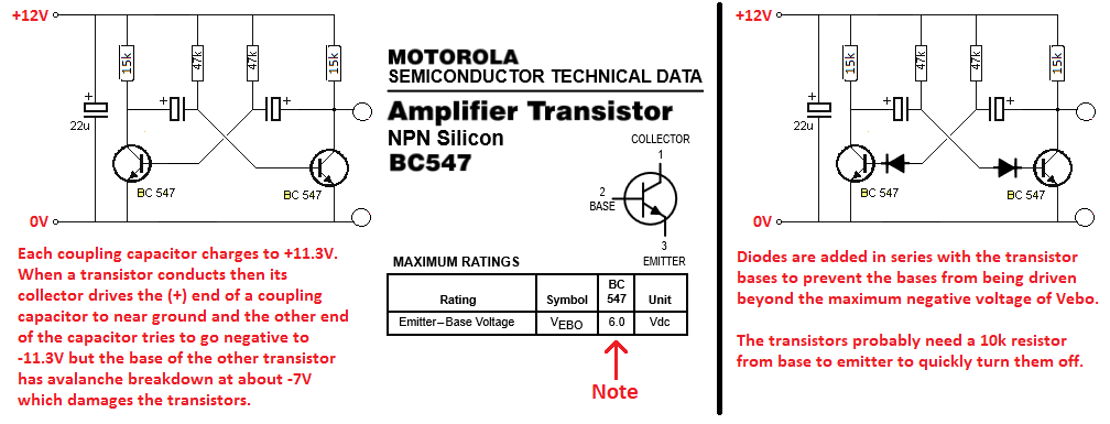

If you want to run the circuit on a higher voltage (9 V, 12 V, etc.), you can protect the transistors by adding a small signal diode (1N914, 1N4148, etc.) across each base-emitter junction, with the diode anode connected to the emitter. This will keep the reverse voltage clamped at 0.7 V. Note that the clamping action will discharge the timing capacitors more rapidly, increasing the frequency of oscillation.
ak
All transistors have a low breakdown voltage of the reverse-biased emitter-base.
The transistor multivibrator circuit capacitor charges to almost the supply voltage and when one transistor turns on then the capacitor will try to drive the base of the other transistor to a negative voltage almost at the entire supply voltage will blow the transistor. Here are protection diodes added:

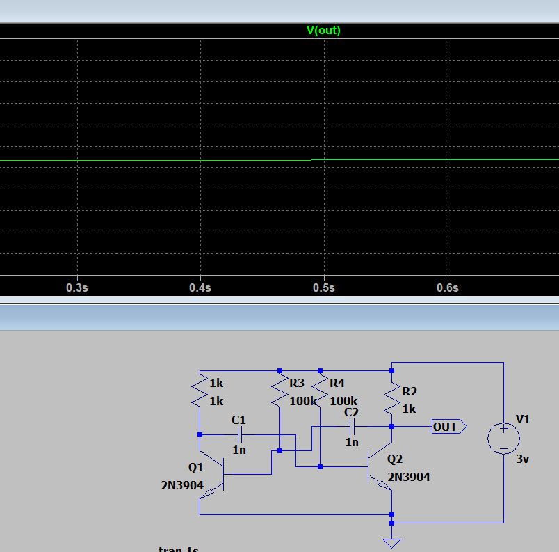

Before I build another pcb a tried to simulated it. I have Isues with getting 50khz. LTspice work only when value of cap is above 10nF.
This circuitry is for 72,4Khz
120340
And working simulation with 10NF:
120339
Does anyone know why this is happening?
No, but simulators aren't real life (so it's not 'happening') - build it and see what happens - BOTH circuits as shown will work perfectly in real life.
You don't need to make a PCB to check it, either build it on a breadboard or simply solder the components together 'in the air' - or build a finalised version on stripboard etc.
Seems to work
So thanks for help
If simulators not works all time, then is useless.

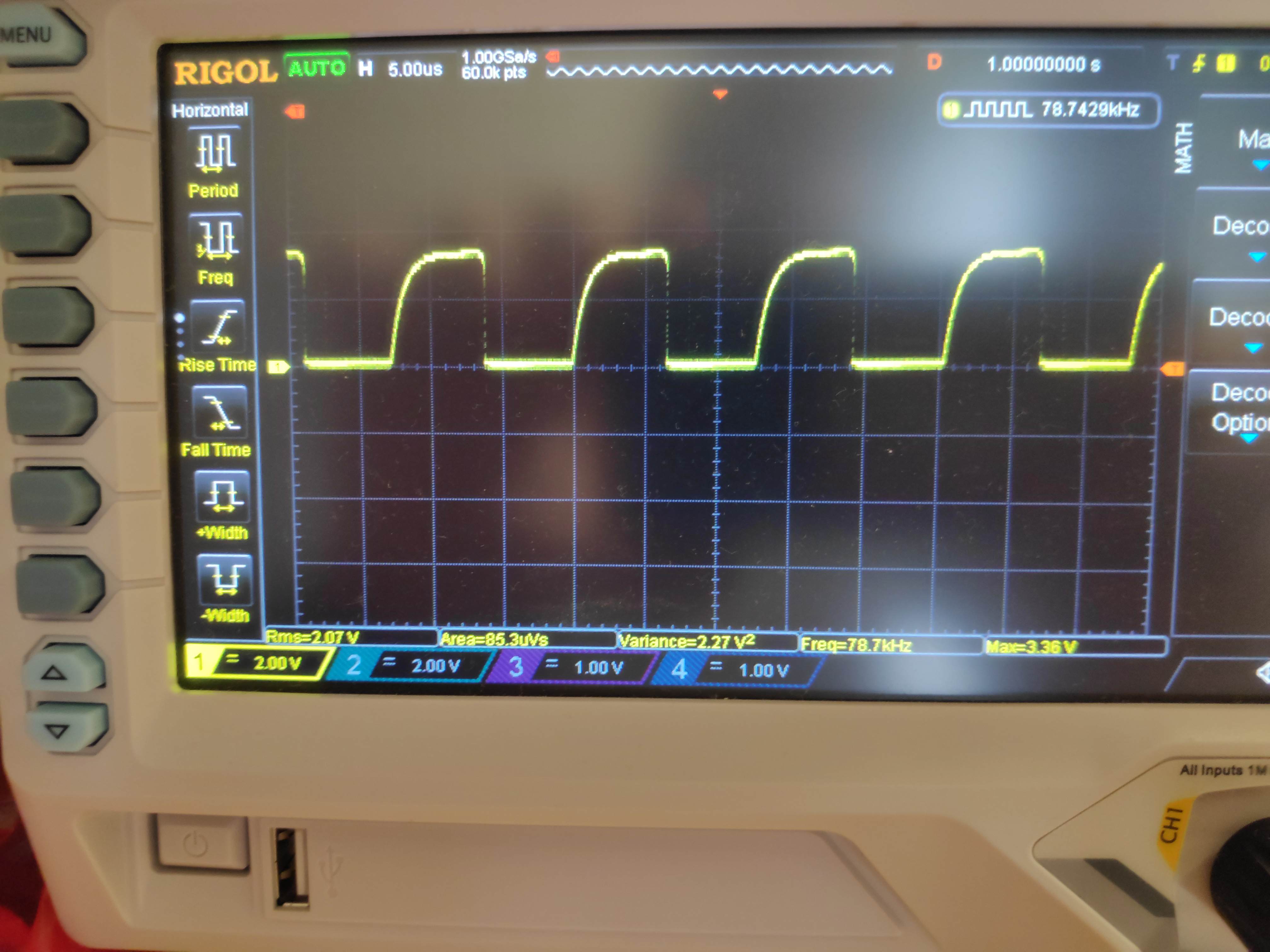

What can i do to make it more square wvae looking?
Looks about right for a multivibrator, why do you need it more square?.
If you do for some reason?, then feed it through a schmitt trigger.

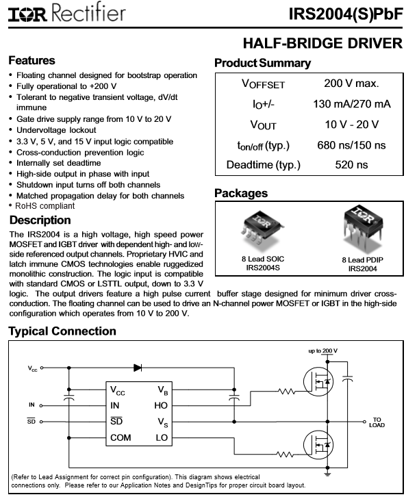

I am trying to make oscilator for mosfet half bridge. I need to use n-mosfet instead of P channel mosfet. Becouse P-channel transistors are weak. So i need galvanic isolation. My idea is to use switching transformer with some flip-flop circuit controlled by RF. For transformer i will use half bridge with pChannel mosfet. Output will be 25V rectified DC.
You are re-inventing the wheel.
120346
This one has different inputs. You get a input for each output. There are many types of these.
120347
To search for more "gate driver", "top side mosfet driver", "bridge driver".
You have a oscillator that is working/almost not working. (when you change the caps to small) If you built 10 units some will work and some will not. It depends on variations in the transistors. Some will work if the supply comes up fast but will not work if the supply voltage comes up slow.
You complain about SPICE not matching your circuit. I say your circuit dose not match your circuit all the time. Some times you will get transistors with a gain of 300 but next time the gain will be 200 or 400 and the circuit will not work. So the hardware is also "useless".

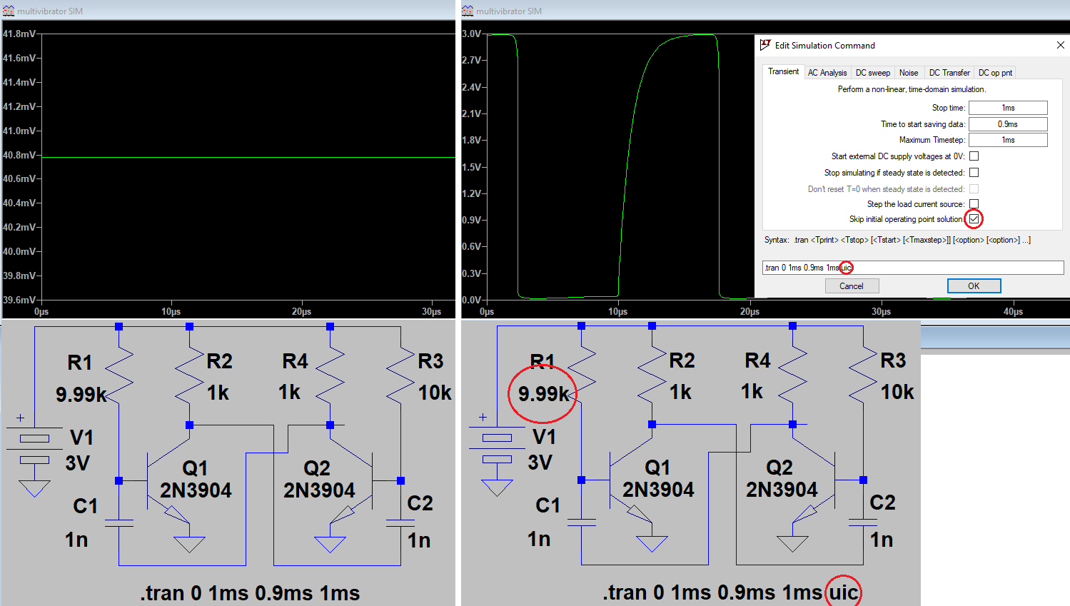

The simulation does not work because the RC timing parts and transistors are exactly the same. When you build it, the resistors, capacitors and transistors will be a little different so one side charges quicker than the other side and the oscillation starts perfectly.
In my simulation, the Transient Setup needs "Skip initial operating point solution" ticked and one resistor value changed a little for the circuit to work.
The waveform looks bad because it is a Mickey Mouse analog circuit instead of a proper digital circuit.
Here is my simulation:
