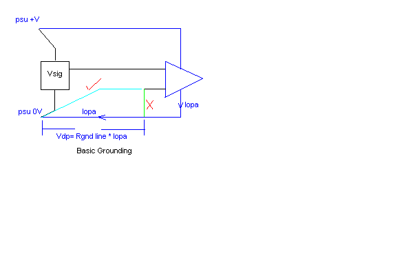

A diagram explains it best.
The problem to avoid is the power supply current for the devices flowing in the signal ground lines.
These device currents cause voltage drops in the ground wiring which can be seen as a change in signal level in sensitive amplifiers,
if the amplifier uses a connection point away from the psu 0V.
In theory by grounding, in whats known as a Star ground connection back at the psu these 'ground loops' can be minimised.

Hi Eric,
Gotcha! Once you put it in terms of "ground loop" I got what you meant. I've had to deal with ground loops in audio (stage and studio) situations but just wasn't thinking about it in this context. Makes total sense.
Thanks!

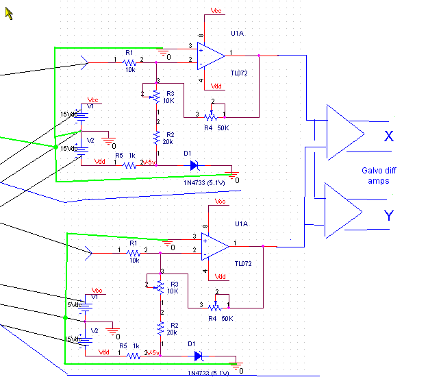

hey guys. Just finishing up the circuit now. let me explain exactly what I am doing.
Well, basically, you all know that a sound card, is basically a digital to analogue converter. I have a laser projector, that uses galvanometers to control the beam. They are setup in a X/Y configuration, and are controlled by a +5/-5 volt signal. Since the real lasershow controllers are VERY expensive, it has been discussed that you can use a sound card do do that. SO basically, you just take the signal DIRECTLY from the DAC chip on the sound card (Before the coupling capacitors at the output).
This then gives you a raw analogue signal, which is what you want. Now, one of you 2 may know, but what EXACTLY does that circuit do? Does it just amplify the signal?
The reason I am asking, is that driving the galvo's from the sound card DIRECTLY works, but the output is quite distorted. Is there anything in that circuit, that would somehow optimise the output? I am thinking this, because the output image size, with just the sound card is reasonable, and I dont know why they are so distorted.
Any idea's?

It sounds to me like the laser projector has a control input which has 2 connections: signal (+-5V) and gnd. Is this correct? If so, I would think that you want the signal centred on gnd, which as far as I can see would mean just connecting straight out of the sound card outputs (i.e. don't skip the coupling caps) and lose the Zener. I may well be missing something here--I'm just a hobbyist. :) There are lots of real EEs on the forum.
As I read it, with both pots centred, it inverts the signal and amplifies it by 3.5 times.
[Edit: With the 5.1V Zener in place it also imposes a +5.1V DC bias on the signal.]

How is it distorted? What does it do that you do not want?
Torben
What voltage do you measure at the input of you amp [the signal line] when you have no audio input drive to the sound card.?
I suspect its +5V, can you measure and let us know.
What voltage drive levels do the galvo's require.? and whats the galvo resistance.?

Hi, I am not using the amp right now, but by "distorion", I mean the output pattern/image is really messed up. For example, if I try get it to draw a regular circle, it comes out as a circle, but with ALOT of loops in it. almost like its "pulsing" somehow.
EDIT: the circle comes out kinda like this, but more even and with more loops:
EDIT: Just found out, when the sound card is doing nothing, it has like 2V at the output, would that do anything like this?
That explains the purpose of the -5V offset voltage.
Set the R3 pot so that the output of the OPA is zero when the sound card has no audio input.
Keep the OPA gain set R4 low for starters.

I am not driving the GALVO's directly, the galvo's have thier own little amplifier. So basically, I am supplying the galvo amplifier with a signal, which they then control the galvo.
The galvo amps state: Input: +-5VDC differential
they have a input for a + signal, and - signal.
Is this the way you have the galvo differential amps connected when using the galvo's.
Are you driving the stereo inputs of the sound card with quadrature signals for the circle.. sine on left chan. cos on right chan.?
EDIT: you must remove the +2V offset, thats the purpose of the OPA circuits.

Oh man, I was just laughing soo hard, I was wondering why t wasnt working, then I find that I didnt link the -15V to the op-amps LOL.
Anyway, one problem I have now, is that I am getting like 12V on the output!!! :O
Maybe its a problem with having the sound card ground hooked to the ground of everything else, and not just straight to the output?
Here is how its currently wired:
With no audio input, adjust R3 to cancel the fixed +2V coming from the sound card.
This is a MUST else the galvo's will be off zero angle at rest.
It should be possible to make the outputs pin#1 on both the TL072 to be zero.
If you cant set it to zero, recheck the wiring.:)
