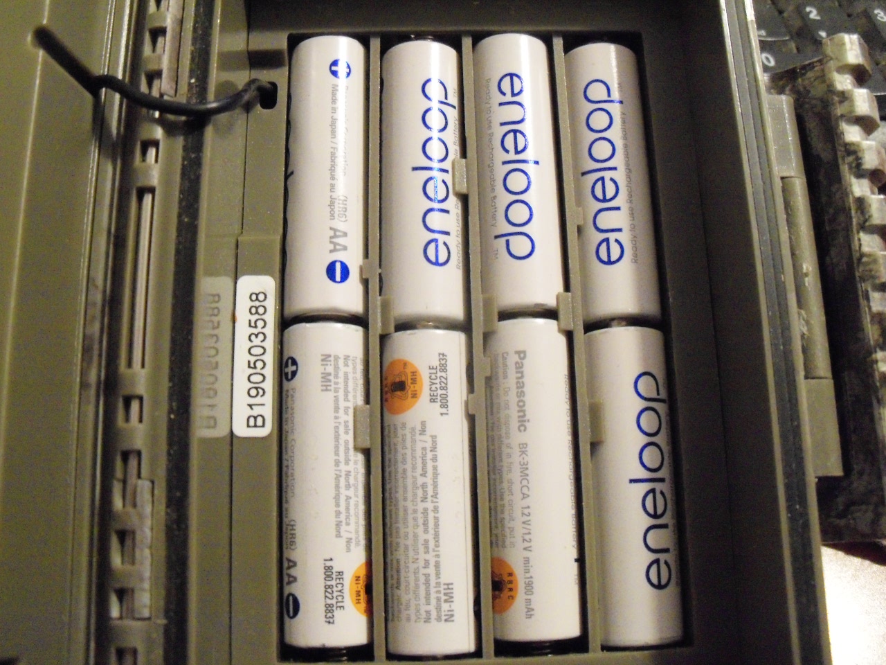

Are rechargeable batteries suppose to last longer than 18 months?
gary350

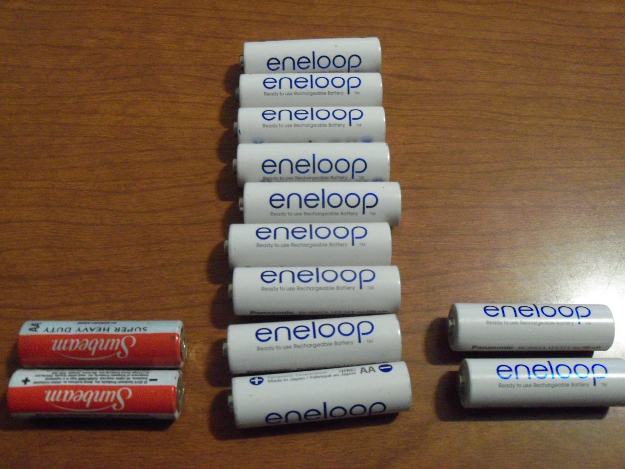

After charging eneloop batteries 6 hours charger says they are fully charged but they are not charged. Camera says, Low Battery. Meter shows 2 batteries are .008 volts. The other 9 batteries are .7v each. Print on eneloop batteries says 1.2 volts. 2 used sunbeam batteries are 1.4 volts. I wonder is charger is a problem I have not been taking notes but it seems to me batteries use to charge in 3 hours and now it takes 6 hours to charge. Is there a way to test this charger?
Eneloop cells are excellent if they are real and not Chinese copies. They should measure about 1.45V when fully charged, then drop to about 1.35V in a couple of days if they are not used.
I think the charger is defective.
NiMH or NiCd cells can develop internal short circuits if left flat for long periods; they should always be stored fully charged (but preferably used and recharged occasionally).
Any cells that are showing near zero volts are likely shorted.
It may be possible to revive them by briefly connecting each one to a high current source to zap the internal short, then charge fully and use!
30 years ago all my Ni-Cad batteries developed a short and needed the short zapped away. Then for the last 30 years none of my many Ni-MH cells developed a short.

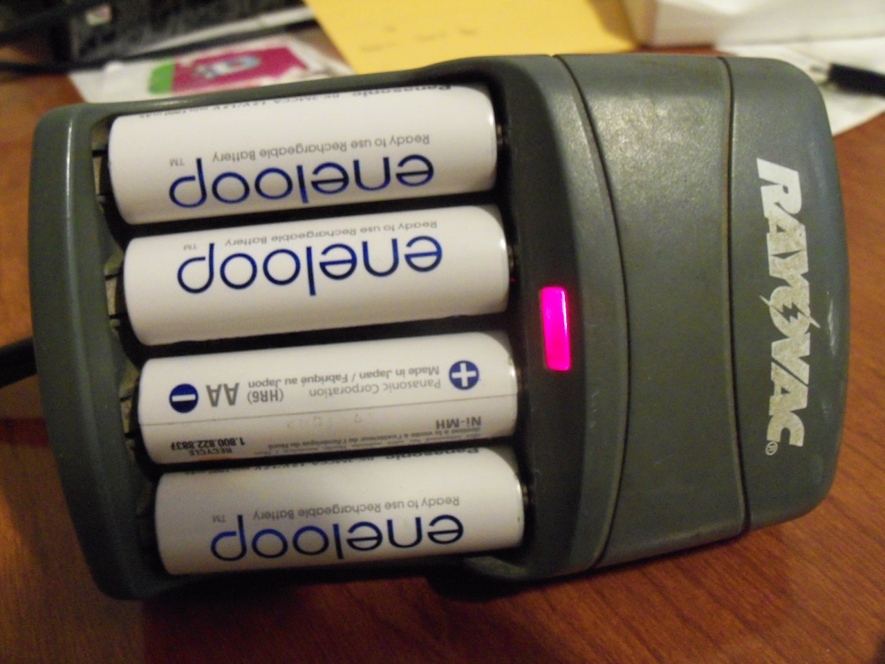

You are right. I charged 4 batteries in the old slow 12 hour charger, they are all 1.476 volts on my meter.

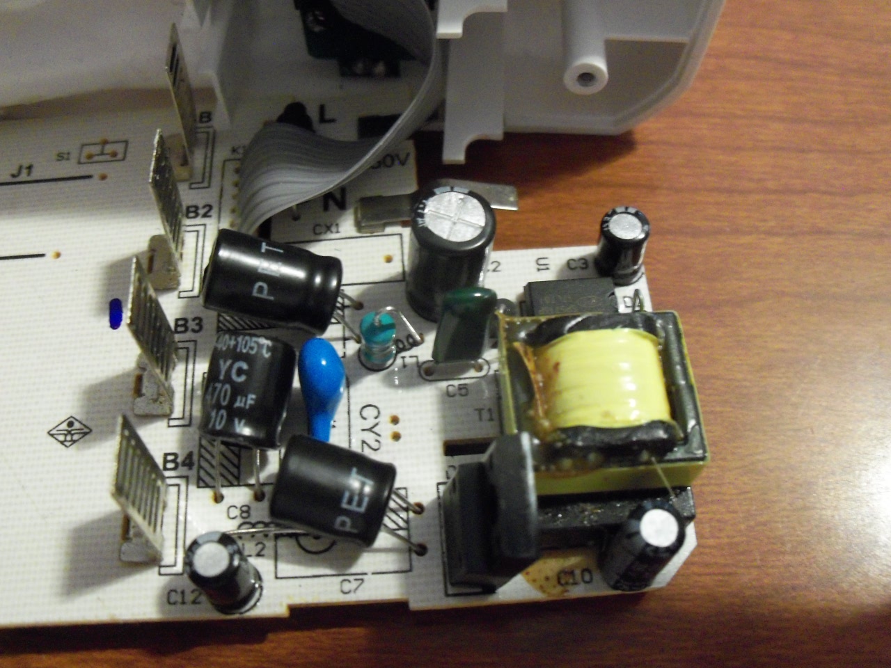

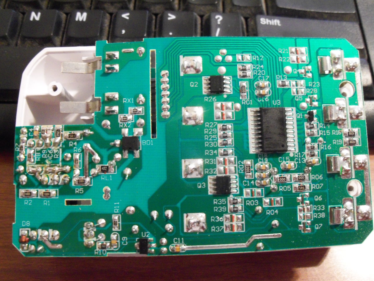

What to do with the EBL charger. Maybe I take it apart to see what is inside. Maybe it is full of rice. LOL, haha, funny.
OH look NO rice. Parts so small I need a microscope to see them. I think I see an SMPS.
