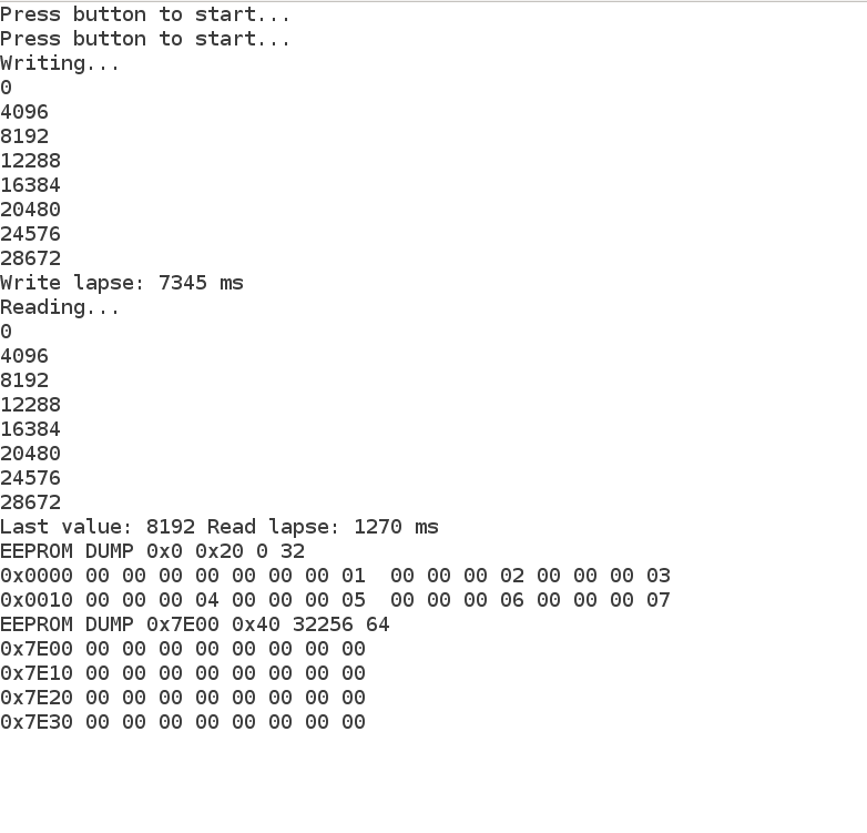

Looks like your slow for some reason
So a '128 would take 1/2 that time at about 600ms, that would have been Ok for this project.
Maybe I ought to look for a better library eh.
There sure not all the same.
The arduino can do the 400khz you have like 10 ways to read one of these you need the newer I2Ceprom library.
