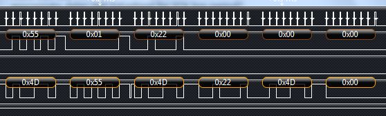

Hey ive been trying this IC still with some progress but no luck! Ill attach a image of my logic analyzer result... the data returned is wrong... or should be that... why am i getting this? faulty IC ? from all the testing ?
This is my SPI Code... (Mixed from microchips sw lib and my own code)

Juts taking a guess, but shouldnt the data output pin be stable for the entire time the SCK is high? So you should output the bit and allow a couple uS for the pin voltage to stabilse then do the SCK pulse.
Like this;
set output pin
2uS wait
make SCK hi
appropriate delay see datasheet for SCK hi period?
read input pin
make SCK low
appropriate delay see datasheet for SCK low period?

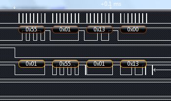

the datasheet sucks heh i dont see SPI timing ... exact timing at least.. i tried your code with no change but i altered my original code and got this which is correct... but the next time i try to do a command i get crap...
OK:
logicar10201-jpg.52346
BAD:
logicar10202-jpg.52347

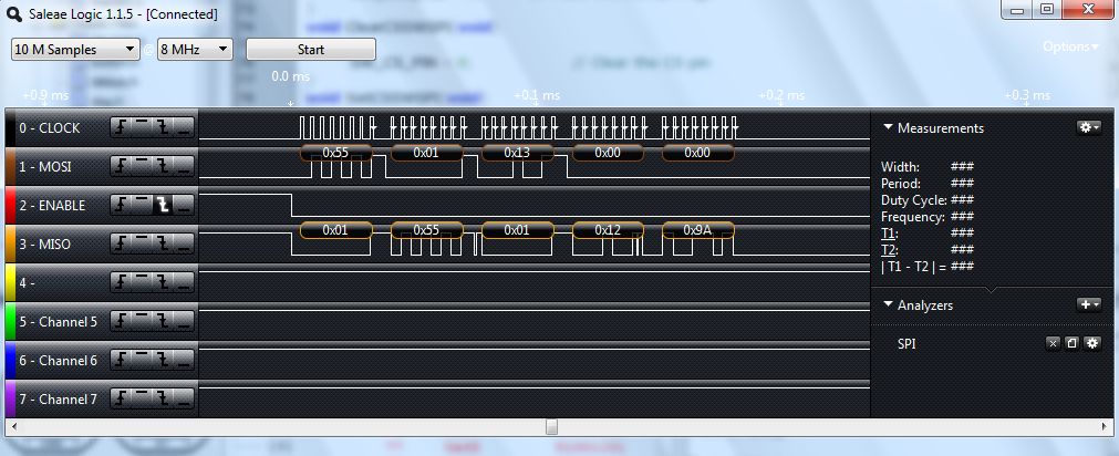

I notice i wasnt polling the SIQ line but i am now and it stops at 0x55, 0x02
I send this:
send-jpg.52348
This is what i get back,...
rec-jpg.52349
Supposed to be 0x55,0x02,0x00,0x13
Why the heck is this causing so many issues. Am i the only one to think this IC is crap ? It cant just be me. To have to work so hard to get a simple touch screen ic working is a shame. Ive gotten harder things working (no nasty intentions :D )
