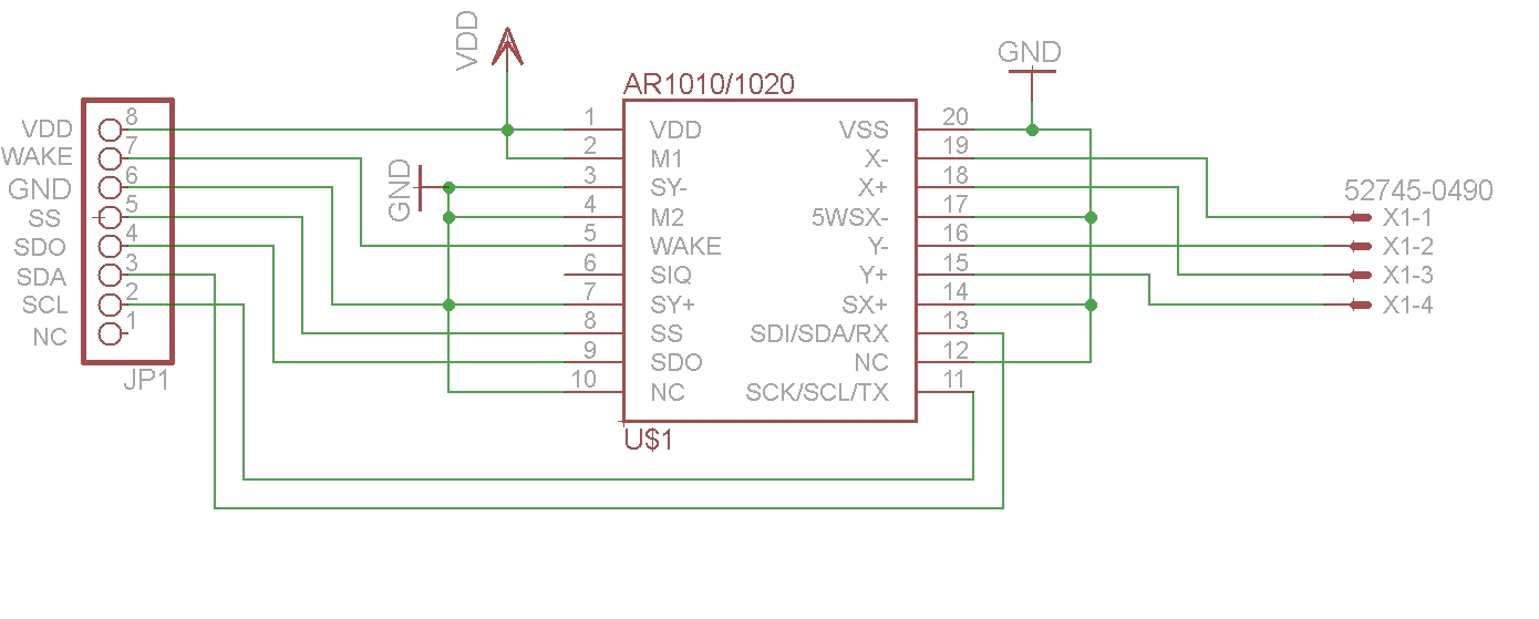

Hey guys i have been working on this for a day now and am stuck. I have tried so many things and no luck.
I have this Touch Screen Controller "AR1020"... im trying to communicate via SPI with no success. Can someone point to me where i am going wrong?

Looking at the datasheet, is the M1 pin tied to VDD to activate SPI mode?
Have you tried using that Pickit logic analyzer to see what's coming and going? Are the lines doing anything... clock? data? Are you sure the phase is correct, the AR1020 has valid data on the falling clock edge.
You can't just leave the card select/slave select line low like that. It is generally used as a start of frame indicator. That's the first thing that jumps out at me.
EDIT: Well, that's wrong. The datasheet specifically states you can tie it low for single chip use.
Yeah heh...
Oh yeah as for M1 here is my schematic:

making a new board now tho... with all required parts but that above schematic is the bare minimum so i should get data to/from ic with no issue
