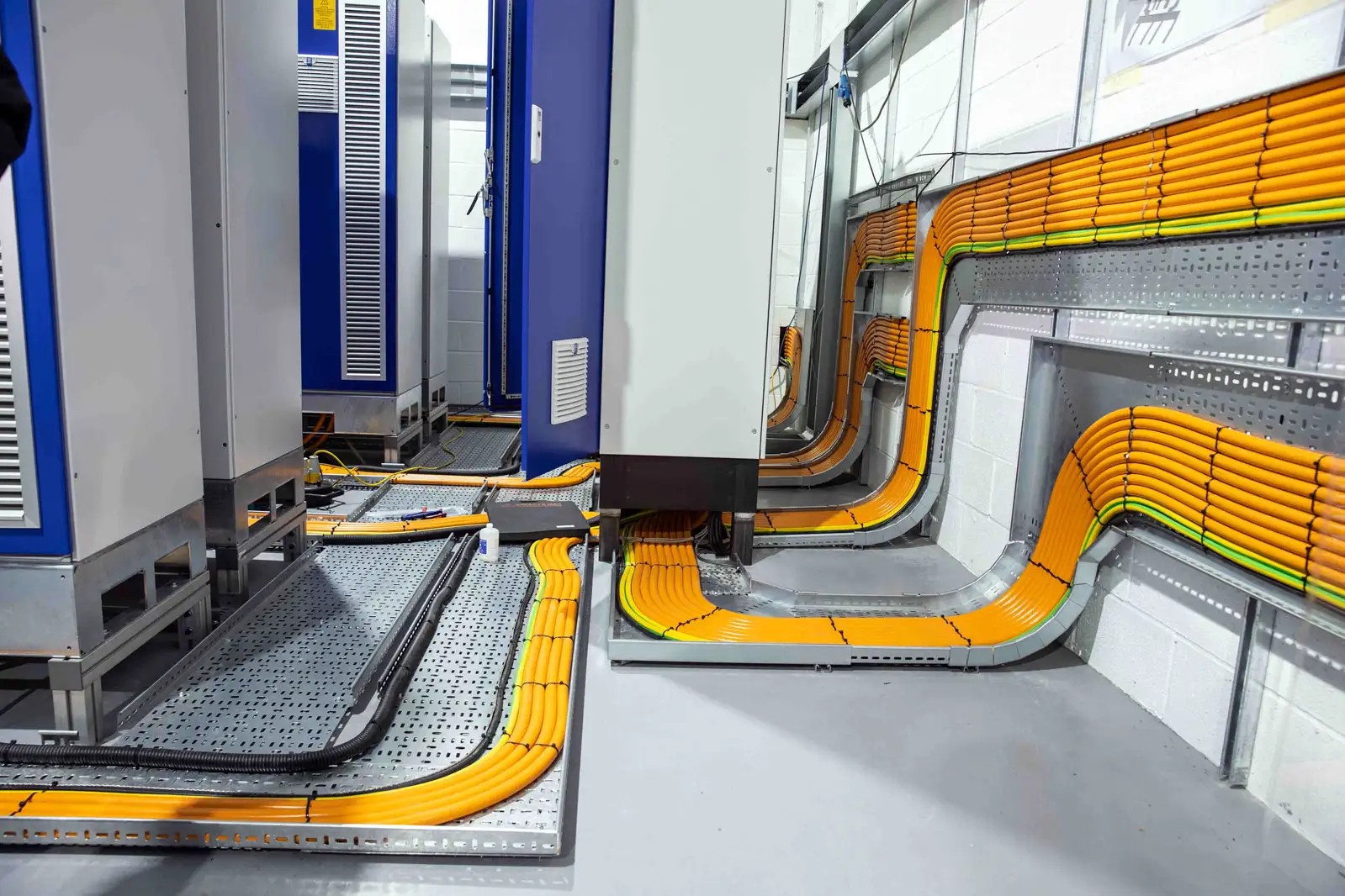

We've just had a new substation installed at work and we can generate up to 1MW via four switch mode power supplies. Either used individually at 250KW each or in parallel for a little more oomph ! View attachment 138954
Well damn!! :D
Aren't those wires beautifully neat.
