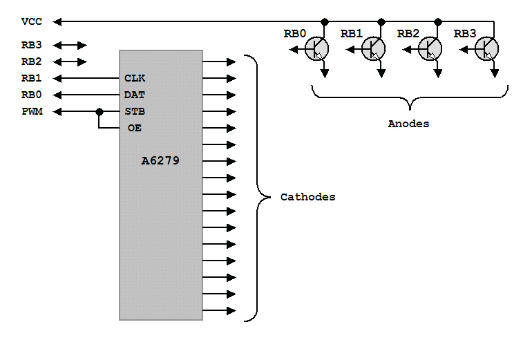

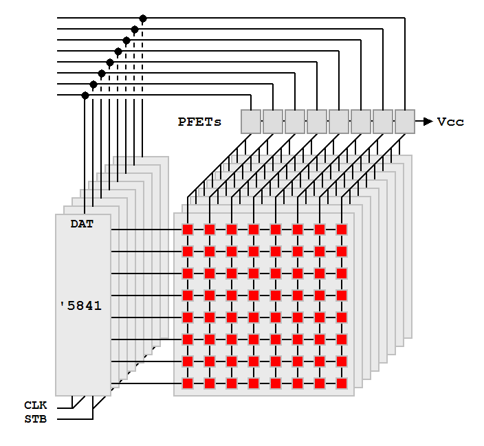

The closest I've come is to recommend a hardware design to a chap for an 8x8x8 cube that would only use 10 PIC pins.
I'm not sure there'd be any advantage trying to Charlieplex that 3x3x3 cube. The wiring would be a bit more complicated compared to standard multiplexed wiring.

It would definitely take some thinking. This thing, the way I've built it, eats 12 pins of I/O, so any improvements would be good. For anything bigger than 3x3 you'd definitely need some additional chips to drive the cube.

You could could use a serial-to-parallel 16 output constant current driver like the Allegro A6279 and a few transistors to drive a 3x3x3 matrix using 4 PIC pins or a 4x4x4 matrix using 5 PIC pins and you'd have full brightness with PWM brightness control as part of the bargain.
I'll have a look at that for future cubes.
I was just looking at the MAX7219. I have a couple here. They're made to do only 7 segments and DP on up to 8 digits multiplexed by the chip. Doesn't help much when each level ("digit") I want to multiplex is 9 segments. Ah well, there's lots of other chips out there.

Just happens to work out perfectly for a 4x4x4 cube though, doesn't it (grin)?
