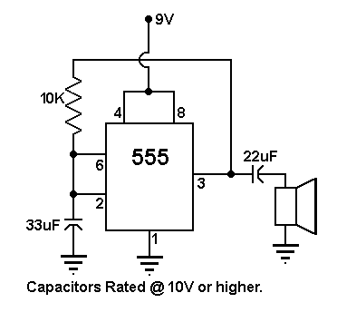

Just use a 555 to Produce a Slow 1 or 2 Hz Pulse, through a 100 uF cap and into a Speaker. (Thump, Thump, Thump ........)
It will help to attract fish.

A 555, 3 resistors, 3 capacitors, piece of veroboard, speaker, case, bits of wire, battery & connector.
Probably under 10 quid.

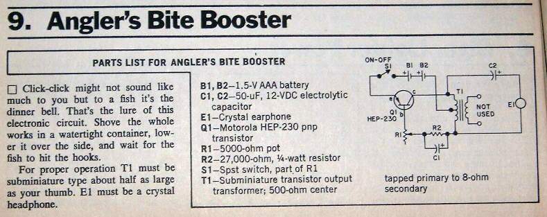

MANY, MANY YEARS AGO, this was published in a Electronic Magazine. (I Think in 1960's or early 70's)
These parts are probably hard to find now, Especially a Crystal Earphone.
But it can be done quite Simple with a 9 volt battery, a 555, a few resistors and capacitors and a small speaker.
Cost depends on what parts you may already have.
I can post you a circuit a bit later today.
The trans is sometimes refered to as a lt77, ebay probably has some.
This is as Simple as you can get.
Just Use a Small Speaker 2 or 3 Inch Diameter.
Impedance Not Important, This was Tested with an Old 8 Ohm Speaker.
It Goes: Tick, Tick, Tick, Tick .................
For a Slower Ticking, use a Higher Value Capacitor in place of the 33uF.
Examples 47uF or 100uF
For Faster Ticking, use a 22uF or 10uF.
Or Change the Resistor Value
The Faster the Ticking, the More Current it will draw from the Battery.

you can still get lt77's in the uk, but they are drying up, I have non left, lt44's which were used for transistor drivers were also common, they are dissapearing too, but then they havent been in commercial stuff for, dunno decades?
HEP230 replacement
NTE104 TRANSISTOR PNP GERMANIUM 50V 10A TO-3 AUDIO POWER AMP
HEP230 replacement
This is a Very Old Design, when Germanium Transistors were the Most Common.
A 10 Amp Transistor is a HUGE OVER KILL in this circuit.
Considering this circuit uses Two, AAA Batteries it is only running at 3 Volts.
And with the Transformer, Connected as in the Circuit, it has a Resistance of 250 Ohms.
So Maximum Current is just 24 mA.
Probably just a 2N3906 Transistor would work.
I Can TEST it out, If anyone really wants to build this circuit.
I disagree with your analysis. This is a 3V cct with a very low duty cycle and low frequency pulse generator that can draws many Amps limited only by the Rce of the Germanium and Rs of the primary coil. The reason a 10A transistor was chosen half a century ago was it was the best choice for low Rce and a 3V relaxation oscillator.
Now you can do the same with a power low threshold MOSFET. The theory of operation is to generate as much voltage as possible for the piezo output exciter from V=LΔI/Δt using 3V THe large Cap does this with a DC current limit of 27k. Thus the average current is low due to the quick turnoff time and slow charge time.
It doesn't have to be PNP as NPN with reversed battery can do the same, but the Germanium just happened to be the best at the time.
So it will go tick, tick tick.... at an adjustable rate.
I was only showing that a current replacement part number was active, not endorsing the design.
