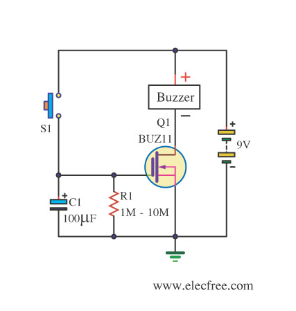

Yet, that's not good enough, for if the thieves forced me to hand over the car's keys, I want them to get away for about 30 seconds and then the engine stops. I. o. W. I would need to add a simple delay.
I need some idea on how to momentarily fill the electrolytic condenser, which then gradually bleeds itself out and so, allowing a couple restarts.

A simple capacitor and relay as you showed on another site will not work well for the delay, because the delay will be too short with any reasonable values for capacitance and relay coil current. A better solution is to build the delay with an resistor and capacitor controlling a mosfet switch. In that way, you can use a larger resistor and get longer delays. A member on the other site showed a simulation for such a circuit. Just for reference, here is a similar circuit:
C1 x R1 controls the delay time. The buzzer would be replaced with your relay coil. Also note that this type of the mosfet (N-channel) must be between the load and ground and will need to have a suitable voltage rating for automotive use.

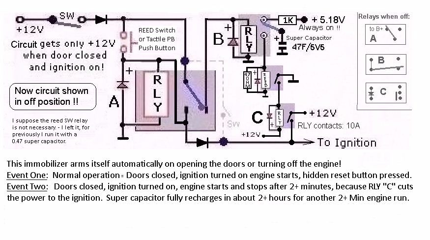

Thank you jpanhalt for this circuit idea.... Here in St'go de Chile we got drugged 12-year olds "pistoleros" hijacking cars and murdering drivers.. I have only limited electronics knowledge, but need to create such a life saving circuit.
My idea is to peacefully hand over the car keys to a drug addicted car hijacker and just let him know that the car has "mechanical problems..." - the rest then does this hijack immobilizer circuit. I also chassis attached a hidden, locked box in which I hide the car's documents + spare key.
Thus far, I somewhat succeeded in developing it, but there surely are better electronic solutions. In fact a couple of your timer circuits idea might suffice to prevent an engine restart, after engine immobilization?? Maybe you can help me (young pensioner 74) there? Here's my latest circuit idea:
