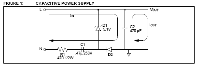

I'm working on a transformerless power supply - I've read all the old posts, I know the risks - disclaimer for everyone else, this circuit could electrocute you.
I was wondering, what is the smallest resistor (R1) in the circuit that will effectively limit inrush current? I'm trying to get ~35mA out of the circuit, so I used 68Ω, 1W, but I'm worried it might be on the small side.

Yes, R1 limits the inrush current.
The circuit you posted can supply a maximum of 15mA.
Use a bridge rectifier and this circuit will be able to deliver about 30mA.
Always put the resistor and capacitor in series with the live conductor for safety's sake.
If you want more current then add a resistor in parallel with the capacitor or use a larger capacitor.
The paper you posted privides all the formulae you should need to calculate the current a capacitor value.
Thanks - I actually just posted that circuit for reference. I'm changing the capacitor to 1.5µF, and I wanted to change the resistor to 68Ω - I'm just wondering if that's enough to limit inrush current. How do you know how much inrush current is too much?

The live is at 230V with respect to earth and the neutral is near 0V with respect to earth.
The inrush current can be calculated using Ohm's law.
Mains rated 1.5:muF capacitors are quite big bulky and expensive, you're better off using a full bridge rectifier and halve the size of the capacitor.

The capacitor starts off at 0V so the maximum possible inrush current is the peak voltage over the series resistor.
The inrush current isn't normally an issue anyway. With a 10Ω resistor and 230V the maximum inrush current would be 23A which wouldn't blow a 13A fuse (I doubt it'd even blow a 3A fuse) as with 470nF the RC time constant is only 4.7µs. You could probably even use a 1Ω resistor, 230A for an RC constant of 470ns won't do any damage.

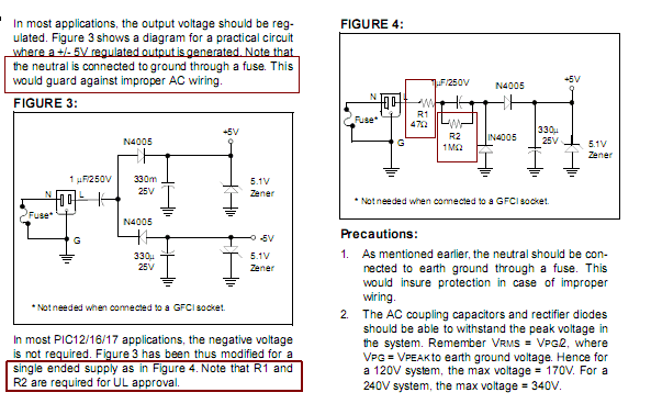

The UL requirement for the capacitive driven mains psu is that a 470K or 1M0 must be connected across the capacitor.
Also a 47R or 100R must be connected in series with the capacitor.

Is there a UL standard/requirement or some other literature that covers transformerless PSUs? I know there's a section at the end of the app note, but I haven't found anything outside of that. Thanks

That can't be a UL requirement because it will limit the inrush current to only 7A, many appliances take larger surges than that.

So 'builders' are aware that these components are required, if their designs are to meet the UL safety codes.

Look at this extract from a microchip application note:
Posted earlier.
The series resistor to the capacitor is there to limit surge current to the capacitor, which has a detrimental effect on its useful life.

That was my main concern - how much do I need to limit inrush current to prevent damage? I'm planning to use 68Ω-100Ω series resistor. I was also intending to use an X2 capacitor, but they're huge, so I looked at another device which has a metallized 250VDC polyfilm capacitor, which has UL approval. Do I need an X2, or will any metallized polyfilm cap work?
This cap is cheaper and smaller, but it's only rated for 250VDC (U.S. device) - if it's used on a 120VAC line, 170Vpk, wouldn't they need at least a 340VDC rated cap? Or 250VAC rated?
