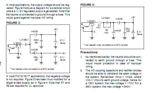

The zener voltage depends on how many LEDs are connected in series.
The current through the LEDs is (Vz-Vleds)/100.
This is a full wave type and provides more light per farad than a half wave type.
Note also that this unit uses a zener to help limit the surge through the LED
when first plugged in or for random line transients.
One thing i almost forgot to mention is that a 1Meg resistor (1/4 watt) should
be placed across the cap to make sure it discharges in a reasonable time after
the unit is unplugged.

Keep in mind, your two competitors can still be sued into the ground if their designs kill somebody. UL doesnt mean squat if the design is inherently dangerous and shortcuts can be pointed out (no transformer etc..).
After reading your initial posts, I saw no indication that this is what you were after. For all I know, you are some cheapskate tinkerer who will get killed trying to save some $$$ at the expense of safety. So you are making a "me-too" product?
Your product will be tested to regulatory standards like mains surges and EFT etc.. those kinds of things right? You came to this forum (mostly noobies these days) looking for safety-design advice? Doesn't your company have an expert or committee? My advice to you is hire a consultant.

hero,
Look at this extract from a microchip application note:
Posted earlier.
Connecting the neutral to ground through a fuse?
That sounds like rubbish to me.
I don't know about the US electrical code but the IEE regulations state that the neutral should never be connected to ground by anything other than a filtering capacitor.
Sorry I still don't believe it, there must be an error in the datasheet. I agree that there should be a resistor in parallel with the capacitor and in series with the capacitor. I just don't think the series resistor needs to be such a high value, as long as it limits the surge enough to prevent the fuse from blowing or the components being damaged then it doesn't matter.
