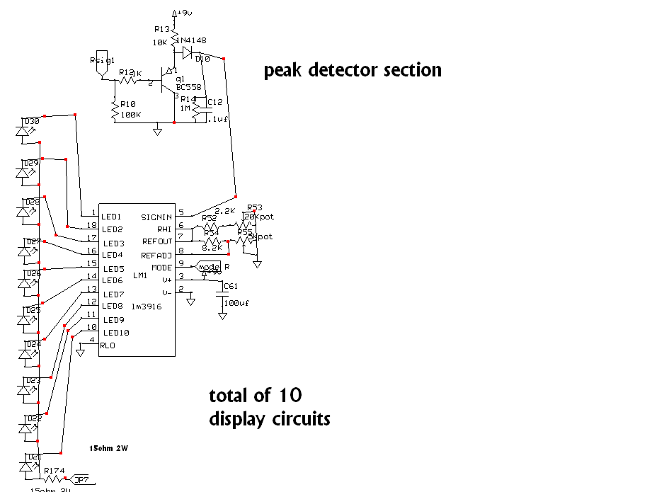

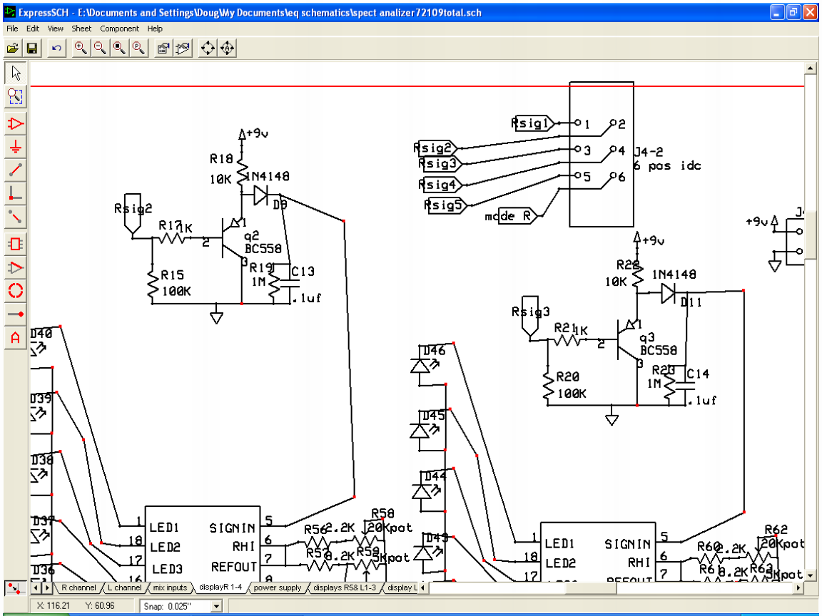

the peak detector section is from the data sheet for the lm3916

For eye candy, I would choose the logarithmic LM3915 over the linear LM3914 because it is less likely to be pegged to the max during loud passages or doing nothing during the quiet part of the music.

A PN2907A would be better since it can handle more current than the 2N3906 which is only good to 100ma or 200ma depending on the manufacturer. The PN2907A will handle the peak 200ma required with ease. I would use a lower base resistor of 1K for the PNP drivers since the 10K will only supply a little over 1ma. (Page 23)
the transistor that is refered to
doesn't carry a-lot of current as its only used for a peak detector circuit.

Well, i've been going over the parts and LEDs are expensive! i'd pay 25$ for a 10x10 display :/ and with MrDEB's schematics i'd need 10x lm3916 (due to a brightness issue)

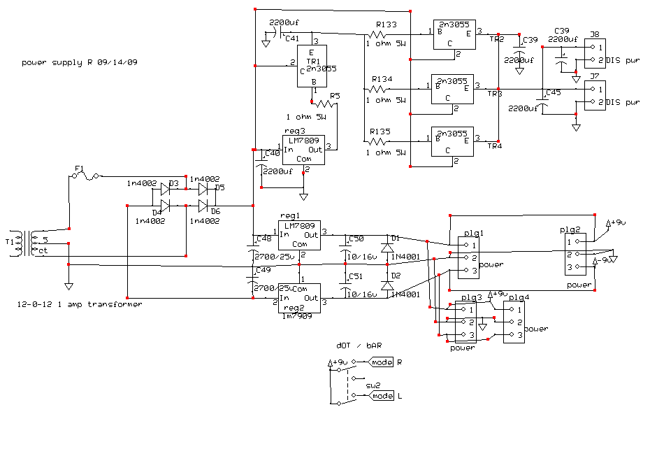

after it was pointed out that my power supply fore the graphic equalizer/spectrum analyzer was inadequat I made some revisions that should supply more than enought current.
just need to make pcb revisions to accommodate the J7 and J8 plugs
note this schematic was designed over numerous posts last year so hopfully the display design is correct. Should be.

A huge 2N3055 power transistor is good for 10A. You have three in parallel so your load is 30A??
The 2N3055 transistors are all emitter-followers so their output voltage is about +7.5V. Emitter-followers do not need a resistor in series with the base. The transistors that are in parallel need a resistor in series with each emitter to balance their Vbe. But you don't need three 2N3055 transistors driven by another one.

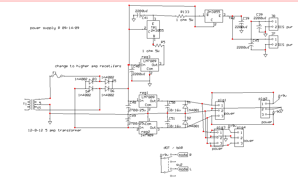

You need only a single 2N3055 transistor without the 1 ohm base resistors and without the five 2200uf capacitors. The LM7809 that drives it needs a 10uF output capacitor. Add a 100uf capacitor to the output (the emitter) of the 2N3055.

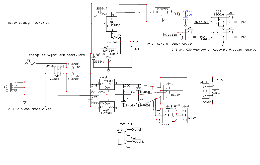

Revised power supply as per suggestions
the plugs for the two seperate display boards have caps as I believe tis is common practice for off board connections? 2200uf might be too big??, thinking 100uf??
the resistor R5 is still in place as per link.
High Current Voltage Regulation - Electric Circuit
may not be correct??
a question I have is on the display boards it was suggested looong time ago to use a 15 ohm resistor for brightness due to multiplexing.
I assume the 3916 is multiplexing??
