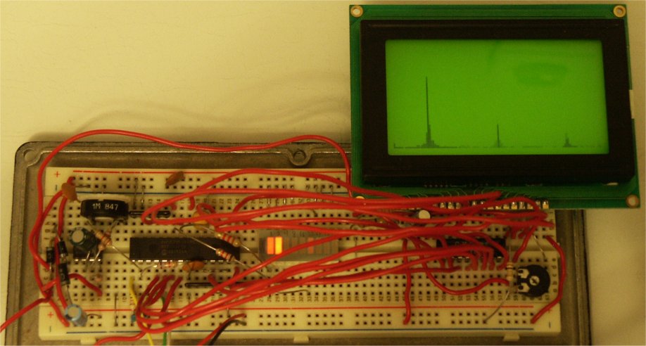

Here is an example of a simple spectrum analyzer I built with a dsPIC33FJ64MC802, AGM1264F GLCD and a 555 timer. The 555 was used to generate a 200-5000Hz square wave for test purposes. It is on the left side of the photo. I knew I'd find a use for a 555 timer one day. ;) The LEDs in the center helped in debugging the GLCD routines.
Since MicroChip supplies a DSP library which includes FFT routines and I had just received my GLCDs from **broken link removed**, I figured this would be a good challenge after my "Hello World" on a dsPIC. I wrote the code in 7 steps:
1) Hello world LED flashing and navel gazing.
2) Getting the ADC to output something meaningful to some LEDs.
3) Writing/testing some GLCD routines. (A little bit of futz's code in there)
4) Wrapping my head around FFT, complex numbers, etc.
5) Playing around with the MicroChip FFT library in SIM.
6) Writing a fast 16bit integer square root routine. No floating point here.
7) Integrating all of the above.
My to do list:
1) Make the span, resolution, etc, settings adjustable on the fly.
2) Add a LPF to the ADC input.
3) Bump up the dsPIC's clock and see how much bandwidth I can squeeze out of it. It is currently only clocked at 7.37Mhz and the display updates apx 4x a second. Span is 0 - 5000Hz in 39Hz steps. Not bad.
4) Compare it to a HP spectrum analyzer.
5) Clean up the bodged source code and post it. :)

Looks really good so far!:)
What is that metal plate under your bread board? You aren't going to - gasp:eek: - box up the bread board in a case are you?:D
The metal plate is a square lid from an old Hammond box. At the first job I had, they manufactured a device that used a large Hammond box. An engraved panel was fitted in place of the lid. Needless to say, many of these lids were discarded. The lid, with some rubber feet, makes a good base for mounting breadboards and development PCBs to.

There are 1024 bytes of data which make up the 64x128 bit display. The data sheet states that you can cycle the enable line every 1000ns which would give you a crazy 977fps. However, when I tried this, the display would get "busy" and wouldn't accept data at this high rate. Since I'm not blanking the display on this project and simply overwriting each vertical column with each FFT sweep there is no noticeable flicker at all at 4fps. The pixels dance nicely.

Yup, it'll do 40MIPS with the PLL but will draw apx 90ma at that speed. I agree, it is rather complicated to switch oscillator configurations so I'll probably go the same route rather than decipher the Chinglish data sheet. :D
The large amount of RAM, the high speed ADC, and 40MIPS were the reasons I chose this 33F series chip. It was nice that the GLCD had TTL compatible inputs on most IO pins so mixing 5V logic with 3.3V wasn't a problem.
That's why I like the 33F family too. With the GLCD I was plazing around with I think I got 150 fps without the bussz flag. And your right the GLCD is a major bottleneck. There is a good workaround tho, you use a buffer inside of RAM and draw everything in to that. Then after the frame is drawn its dumped to the LCD in a big chunk. It may not realy help your current app but if you are drawing lots of stuff on the display it can give over 10 times faster performance.If your are working with dsPICs you mostly are not gona cry for that 1KB of ram used by the image buffer. I have wrote a simple lib for working with GLCDs. It can draw 100 pictues of about 90x90 with trasparacy and still keep going smoth.(Ii also did floating point math to make each picture bounce around the edges of the display) Without a buffer this would grind down to a painstaiking 1fps or less. I was runing this on a dsPIC30F

If I remember correctly from an earlier post, the BGMicro display needed a negative voltage. Is that voltage source supplied on board the GLCD unit?

The negative supply voltage is generated on board the GLCD unit itself. I was also in doubt about this when I looked at the datasheet because they showed it powered by two supplies (One -10V and one +5V) and that the DC-DC converter was optional. I ordered 4 of these displays and they all have two 7660's on board for -10V generation from +5V.

Yes a scope can also work. But the biggest "optimisation" is switching on the PLL to crank the PIC to its max 40MIPS.The PLL switch on sequence is used in most code examples on microchips website(works on all 33F)

I am drawing left to right, bottom to top and taking full advantage of the auto-increment feature of the Y address counter. Does blanking the display, via the 0x3E command, allow faster writing? Currently, I do not blank the display.
