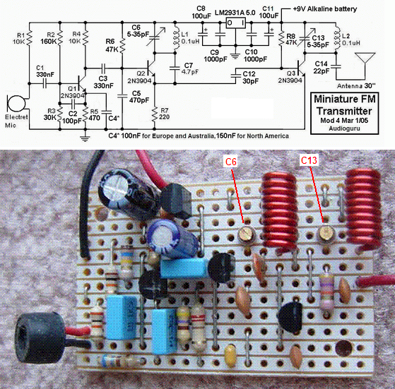

This is my FM transmitter circuit. I built it on stripboard and I cut the strips with a drill bit. The strips form half of a pcb.

Dear guru,
Is L1 and L2 by 10 turn of 1mm wire on 3mm former in your this FM? Is 1mm means 20 SWG?
There are some question, trying to know from a year, please...guru:
1) Oscillator and RF amplifier separated circuit (like your) gives more RF power and long range too?
2) Is it possible to make different another RF buffer stage using 3904 for great range? Please guru, design or show me a circuit like this.
3) I heard that S8050 gives more RF output power better than 3904, is it true?

Dear guru,
1mm wire is thick. It might be 14SWG. They have 9 turns. It has enamel insulation.
The RF amplifier separates the oscillator from the antenna so things moving toward and away from the antenna do not change the oscillator's frequency.
The RF amplifier has plenty of power for a distant range.
A buffer will not work unless the supply voltage is increased and a higher power RF amplifier transistor is used.
The Chinese datasheets give no spec's for use at VHF radio frequencies.
Weitron in Taiwan make an S8050 NPN transistor. Wing Shing in China make an S8050 PNP transistor. Which one is correct?
i an going to build this, so make of clear please.
1) in your circuit diagram, there are 3 transistor but in real built transmitter figure, there are 4 transistors and other additional devices. What is that? Which is this another one transistor?
2) tell me exactely how much gauge in 1mm?
3) are L1 and L2 in 3 mm former?
4) Can i wind aluminium insulated wire instead of copper wire?
5) How to wind coil correctly? When i wind coil, it stretches immediately.
i am going to build this, so make me clear please.
It is the LM2931A 5.0 which is a 5V low-dropout voltage regulator in the same small plastic case as the transistors. There are many 5V low-dropout voltage regulators available today.
[/quote]2) tell me exactely how much gauge in 1mm?[/quote]
Look in Google.
I wound them on a 3mm diameter drill bit.
Can you solder to aluminum? I can't.
I used short pieces of thick copper enamelled wire from the crossover coil in a speaker enclosure. It had lots of this wire.
My wire is solid copper wire that is stiff and stays coiled. Maybe you are using stranded wire that is flexible.
