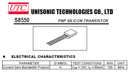

is it possible to use any kinds of "black transistor" for an Fm transmitter? For example s8550!! I didnt mean that in a racial way nor black skin or white skin! He said "use a black one" and thats definitely rude
A Wing Shing S8550 PNP transistor is not black, it is Oriental.
I have never seen one since I use American 2N3904 NPN transistors that work at a frequency that is double the max frequency of the S8550.
I went to China to find a UTC datasheet for their S8550 transistor. It shows no skin colour so it might be purple instead of black.
It might not work as an FM transmitter because some of them have a gain of 1 (like a piece of wire) at 100MHz and won't oscillate at frequencies up to 108MHz.

purple? I have never seen a transistor in purple colour.. have u seen one?
