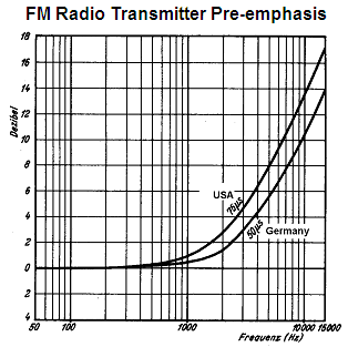

Today's schematic provides pretty good pre-emphasis for Europe and Australia. I don't know how much pre-emphasis is used in your country. Its gain is 0.9 at low frequencies (47k/(47k + 4.7k) and has a maximum high frequency boost of only boost of +20dB at high frequencies.

-Ok then all errors has been improved!!! There was my fault, not in Harry's PCB. :) I have modified pre-emphasis as u said and I will add TL072 as additive mixer later (look at 1st attachement). My country is newly introduced with FM so I think here is used pre-emphasis like Europe and Australia. Thank you!
-I understood that 'connecting 1nf capacitor paralled with 47K resistor in audio line is a pre-emphasis' for Europe and Australia. Am I right? Look at 2nd attachment, is it pretty good too? Can I connect this simple pre-emphasis to all general FM oscillator? (in 2nd attachment:- I connected this simple pre-emphasis to your oscillator)
The 1nF capacitor with 47k resistor is supposed to feed the extremely low input resistance of an inverting opamp. But the transistor oscillator circuit has an input impedance of 22.9k so there will not be enough pre-emphasis.

The 330nf coupling capacitors in my FM transmitter pass ALL audio frequencies the same. The 100nF or 150nF capacitor C4 that bypasses the emitter resistor is used to boost high audio frequencies for pre-emphasis.

C4 on my FM transmitter provides pre-emphasis.
