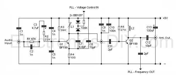

They are calling pre-emphasis to parallel 47K resistor and 1nf capacitor connected at audio input. Actually is it? But I have seen various components involved in pre-emphasis like audioguru's Tx at post #49. I think Mod-4 has buffer too.
www.electronics-diy.com/schematics/TX200_PLL.jpg
The 47k resistor R1 and parallel 1nF capacitor C2 is for Europe and Australia pre-emphasis like mine. But the 22k resistor R2 destroys most of the pre-emphasis.
Where do you find those horrible schematics?
EDIT:
Isn't Electronics-DIY.com in India? On their first page they show the obsolete and poor performance BA1404 IC that has not been made for at least 8 years.
