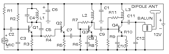

well want i want to ask is that i have attached the circuit what i planed to make but the problem is that i dont fined any place from where i can change the frequency .another thin is that it requires a 30 feet high antene to transmitt but you it is not possible to do this manually so what you advise me to do and last thing what is balun how it works and what it is

MSA said:
thank you.
This is an expanded crude 'bug' transmitter, the frequency is set (mainly) by L1 and C4, plus stray capacitance and inductance. All the other coils really need to be tuned to the same frequency as well for maximum output. Basically it's an LC oscillator, followed by a buffer, then two amplifier stages.
A balun is a "balanced to unbalanced transformer", in this case it's used to transform the 75 ohm output of the transmitter to the 300 ohm impedance of the folded dipole. You could connect a 75 ohm non-folded dipole, or 1/4 wave whip without using the balun.
I don't suppose that you have component values for the components in the picture do you?

The circuit you attached looks very powerful.
It has nothing to hold an accurate RF frequency so its frequency will drift with changes in temperature and supply voltage.
It also doesn't have pre-emphasis (treble boost) that all FM stations have so its reception will sound muffled like an AM radio or like your stereo with its treble control turned all the way down.

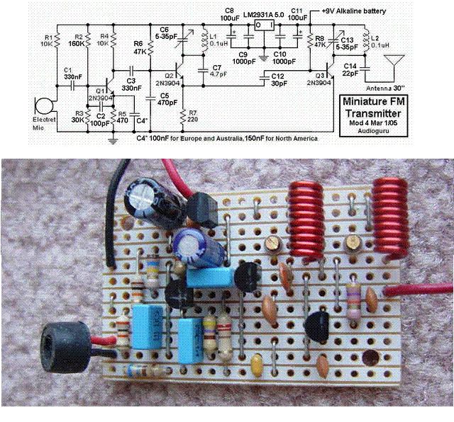

My FM transmitter works very well and has a range of about 2km line-of-sight.
