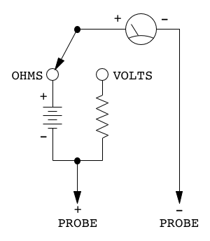

As tomizett commented, It appears that the OP was questioning why the positive probe has a negative voltage on it and the negative probe has a positive voltage on it. The simplest way to explain is to refer to the attached simplified multimeter schematic. In order to have the meter deflect correctly, the battery polarity must be as shown, and hence you get the apparently wrong potentials on the test leads. The manufacturer could add in additional sets of contacts on the range switch in order to reverse the leads when in ohms mode, but it makes the circuit quite a bit more complicated, and not worth the effort on inexpensive meters. Also, since the ohms range is intended for measuring resistances which are generally not polarity sensitive, it ususally doesn't matter.
BobW describes the idea correctly and the diagram helps significantly.
All that is missing now is the equivalent diagram of a DMM set to the Ohms range.
