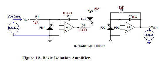

ok i will try to invert PD1 and PD2.

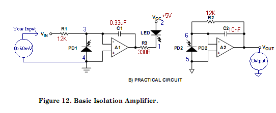

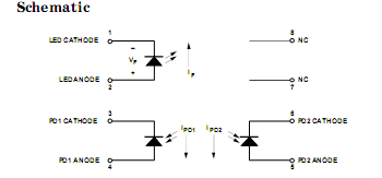

what do you mean when you say "The LED is shown the wrong way around in your diagram." I have invert anod and cathod of the LED ? because in the datasheet i see this schematic (in attach files)

Look at this image from the datasheet and compare it with image you have just posted.

This dwg has the pin numbers.

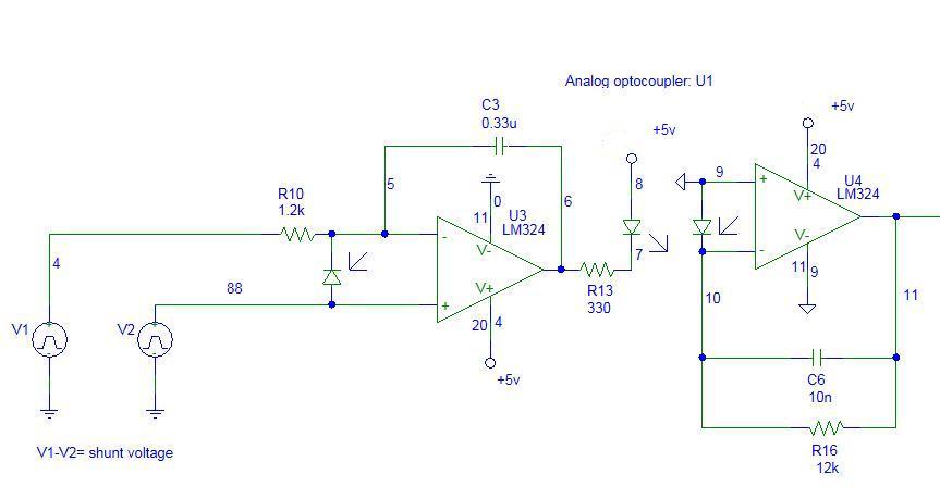

Post a full circuit showing the component values and the power supplies.:)
thank you for your fast answer :)
my circuit is in attach file, for the power supply i use a charger of 5V. I have forget to say that to beginning i use juste one supply for everything, maybe it's the problem, because normally we need two supply.

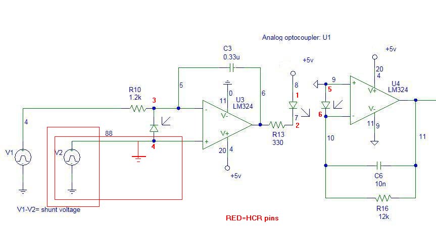

Look at the edited image showing the HCNR pins.
According to the datasheet, for a unipolar device, pin 4 should be at ground.
Read datasheet page 1-431, bottom left column, stating unipolar operation.
For bipolar operation a dual opto is required.
Measure the LED current while the device is working, use a series milli-ammeter.

ok thank you for this information,
i don't know that the pin 4 must be connect to the ground I will try

In my edit for the last post, Im asking what is the current being measured.?
If it has high transients due switching inductive loads, there should a filter/limiter before the PD1 connections.

It's works !!! i'm happy I want this for a long time :)
now i think i will use a divider before the analog optocoupler because i have a bipolar operation as you say !
Thank you very much Ericgibbs.

I would measure the LED current when the unit is working, that will give you an idea which part of the response its working over.
Refer to the LED mA graph on the datasheet.

Hi, i Have mesure the current in the LED
I have a current vairous between 0 to 30uA i have change R1 to 2Kohm to have 30uA when i have +60mV and it's works.

I found this thread searching for information on the use of the HCNR201. I note that the final diagram which worked is as per the datasheet 12b. However, the datasheet does not identify values for the capacitors across the op amps. How were the values in this thread (0.33uF input and 10nF output) arrived at? Also, the LED current limiting resistor is not defined in the datasheet. 330R is obviously a very typical value for a standard LED but is this correct for the HNCR201?
