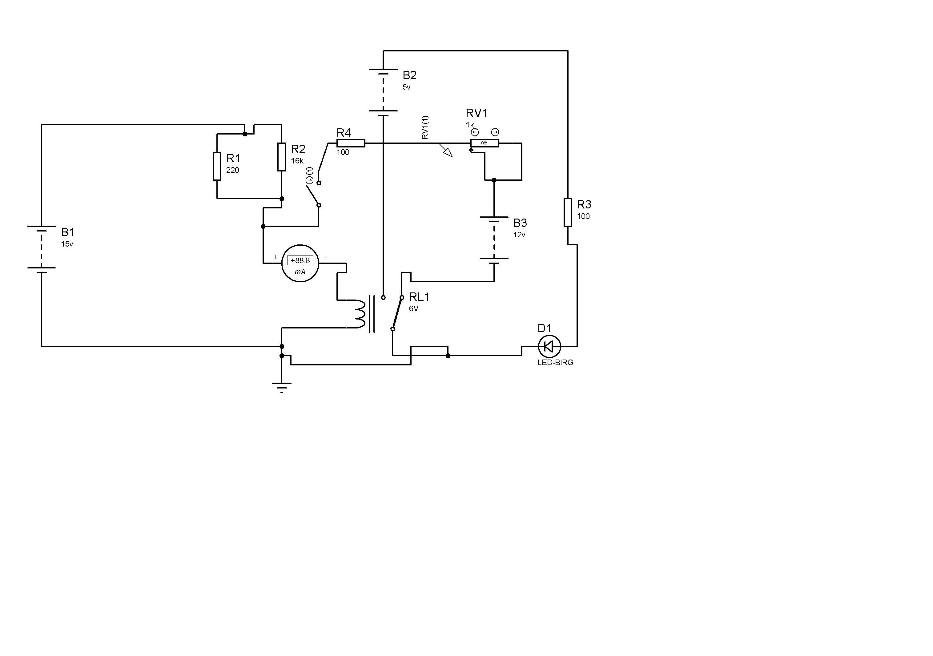

Hi, i am trying to build a LDR based street light(for demonstration pruposes). The light part can be any kind of light(even an LED). The problem is since students have not been taught transistors, i can only use resistors, relays. I bought a 6V relay and found this as its operating requirements:
42.0 ma are required to switch it to the NO contact.
9.0ma are required to switch it to the NC contact again.
In between it stays the same, i-e if it was in NO position, it stays there and if it was in NC position it stays there.
The LDR works as follows:
14KΩ-16KΩ with light
1MΩ without light
Since i can use supplies of up to 15V, i thought i would try and add hysterisis with some feedback but could get it to work. Have been working on the simulation trying to get the proper current but it escapes me. Can any of you guys help me?

I have no idea what your circuit is trying to do but it won't help your problem.
The delta current through the LDR with a 15V supply is only 1mA (dark to illuminated). That's not enough to switch the relay.
To get 42mA to switch the relay through the LDR at 15kΩ would require 630V. There's no way around that. And I don't think there are any relays sensitive enough (even small reed relays) to operate directly from the small current through the LDR 15kΩ resistance at reasonable supply voltages when illuminated.
As Nigel stated, you need some sort of amplifier. Even a single MOSFET or darlington transistor would work. Tell the students that it operates as a switch according to the input signal, just like a relay.
Hi, yes nigel and carl, i know a transistor(s)(or an opamp) as you suggest would be the best way to go. The only reason that i was thinking of trying to it with passive components(primtive? i know) is because this is in a class regarding introduction to electronic components in which the transistor(operation) hasn't been discussed. Guess will have to dump it for later.
The idea in the above circuit is to provide an extra voltage to the relay when it is in the NC state so as to make it reach the tipping point of switching to the NO contact. As you pointed out about the LDRs large resistance(as compared to what is required in the circuit) it is not possible to do so. Posted it here cause i thought maybe i was missing something. Thanks for your replies.

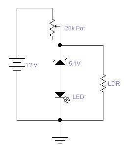

A simple experiment is to connect a high-brightness LED in series with the LDR and a power supply. That would likely cause the LED to light dimly when exposed to light (of course that's opposite to having the LED light in darkness, which is what you really want).
To get the opposite operation you could try connecting a resistor and 5V zener in series with the high-brightness LED to ground. Then connecting the LDR between the zener and ground (see attached) should allow a small current to go through the LED when the LDR is in the dark.
Adjust the pot so that the LED just goes off when the LDR is lit. Adjusting the voltage of the 12V supply voltage may also help.

Hi Wonderboy,
I was wondering what components you would be happy to use,
your earlier diagram includes a potentiometer and a diode,
and what might be a milli-ammeter.
I'm not sure which component is the LDR, i guess it might
be R2 which is shown as 16K-ohms.
Your approach of having some current going through the relay
coil, bringing it nearer to the point of operating, is well
known as 'biassing' and is used with many devices.
However the arrangement you have shown in your accompanying
circuit does not look very likely to work.

Hi, thanks for the replies . R2 in the diagram is the LDR(bad labeling). I have biased it at 9.1ma with light on the ldr, removing the light(covering the LDR with a finger) creates a difference of around .3ma. Tested it and it was able to switch(turn on the LED). The flaw is that once the LED is turned on, i need to restart the supply to perform the same switching again. The components that Ron has mentioned are not available here locally and would the cost to get them here would far exceed their necessity. Thanks again.
