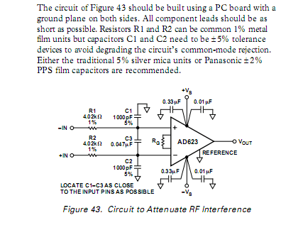

And thanks for the replies. Did not even consider effect of higher input voltage than supply rail for ad623. So thanks a lot for spotting that rather amateur error. I will make the necessary modifications and let you know how it goes.
I have one other question - what is the advantage of the input circuitry you have used for the input from the load cell to the ad623 as opposed to just directly connecting the sensor wires.

That simplified filter on the inputs is in line with the AD623 d/s RF filtering.
