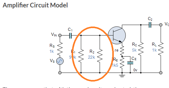

After some time searching, found **broken link removed** explaining input and output impedance of an amplifier.
There is a doubt (I suspect it is related to Thevenin or Norton):
Why R1 is considered in parallel with R2 and why Rc is considered in parallel with RL? After all the current going into RL left already Rc. :confused:

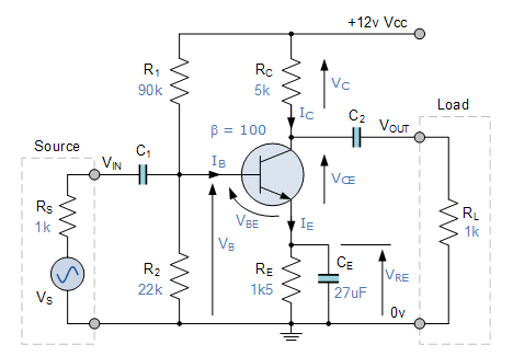

Starting from the circuit schematic, as usually drawn here:
Something which is not shown is the decoupling capacitor from +12v to 0v.
The purpose of the decoupling capacitor is to remove any signals from the 12v line, in other words, it creates a very low impedance (short circuit) at signal frequencies.
The version of the circuit which you show, can be described as the "AC Equivalent Circuit", it is showing the circuit from the point of view of an AC signal.
The DC bias conditions are not shown.
So, consider R2 and Rc, each resistor has one end connected to the +12v line, but, the 12v line is short circuit to the 0v line as far as AC signals are concerned, and so that put R1 and R2 in parallel, and Rc is in parallel with RL (via C2).
Does that make sense?

First time I get the complete story, Jim. Sure it makes sense. Gracias for replying.
BTW, for anyone reading this later, the R2 in bold should be R1.
