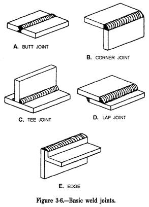

Things to consider in fabricating your boiler.
So now that you're half tempted to build your own AF boiler what are you going to need for materials?
CARDBOARD and TAPE and a FAT MARKER!
Yep. really, cardboard and tape because you're going to want to mock the whole thing up before you ever touch a piece of metal and the reason being is, you need to know exactly how you're going to assemble everything so that you can weld it together and not hit any dead ends with your welds on either side of every seam. This thing needs to hold water for many years to come so doing double sided welds is one simple way to accomplish that.
So how do you know you're assembling it correctly? Well, if you can butt two joints up and tag each side with a marker all the way along and not have a clearance or interference issues with the fat marker along the way you're doing good.
You have to run that welder stinger or MIG gun along those joints later so if you can't get at them with the fat marker you can't get at them with welder either and if not, then you need to change your assembly approach, and if needed, break the overall design down into individual subsections that will go together as larger assemblies rather than piece by piece.
How you approach and finalize your assembly puzzle is up to you but I always start with my layouts on the bottom piece and work my way up and out from the firebox ending with the top.
This is my assembly order preference, Plumbing Fittings on sheets first --> Base plate + Front + Firebox + Flues + Sides + Internal side gussets and bracing + Back plate + Internal back gussets and bracing + Top + External door and cleanout extensions + Doors and cleanout covers that go over them. If you do your assembly right the top sheet or sheets should be the only parts that will not have full welds on both sides.
Obviously, your cardboard boiler doesn't need the plumbing fittings added to it but it does need to have every place one goes marked out and double checked for clarence's inside and out so that any and all external components like valves and pumps have adequate clearance for installation and service in the future.
Few things are more inconvenient than getting the whole boiler built only to find out you have two fittings too close together, or too close to something else, for whatever valve and or pumps attach to them to correctly attach and line up with whatever they need to. That or on setup find a critical one or more totally missing!

So given that, here is a basic list of the common types of welds and the correct terminology that goes with understand what is what.
The vast majority of the welds you will be doing will be the Corner Joint types with an internal side secondary weld or the Seam welds. Now as some of you who are good at welding may say, the inner second weld is not really needed and I would agree since a boiler of this design does not need to hold pressure or require any high degree of structural reinforcement on the welds themselves.
However as some of you may know when it comes to welds being exposed to water for a long period of time they tend to be the point wants to rust through first due to slightly different metallurgical properties of the welding material alloys involved creating weak but very persistent galvanic corrosion degradation issues at them.
I've done loads of repair work welding in my life and weld rust out in water tanks is a common thing I have seen so by my views that second inside weld is just buying you more time in the future. I didn't do the inner side welds or paint liner on my first boiler that ran raw water all it's life and that's where it rusted through. The primary sheet steel is still good but the welds all around the base are what started to corrode out of it.
That, and unless you do professional welding work for a living the odds are you wont run every weld perfectly and have zero pinholes in anything either. ( I always have pinholes)
Granted the inner primer /epoxy paint coating will fix small pinholes that would just seap until they eventually rusted themselves shut but for larger ones the paint/epoxy is not a reliable plug in my views.
Especially if you are going to run antifreeze in your system and need to buy 100+ gallons of it at $8+ a gallon.
