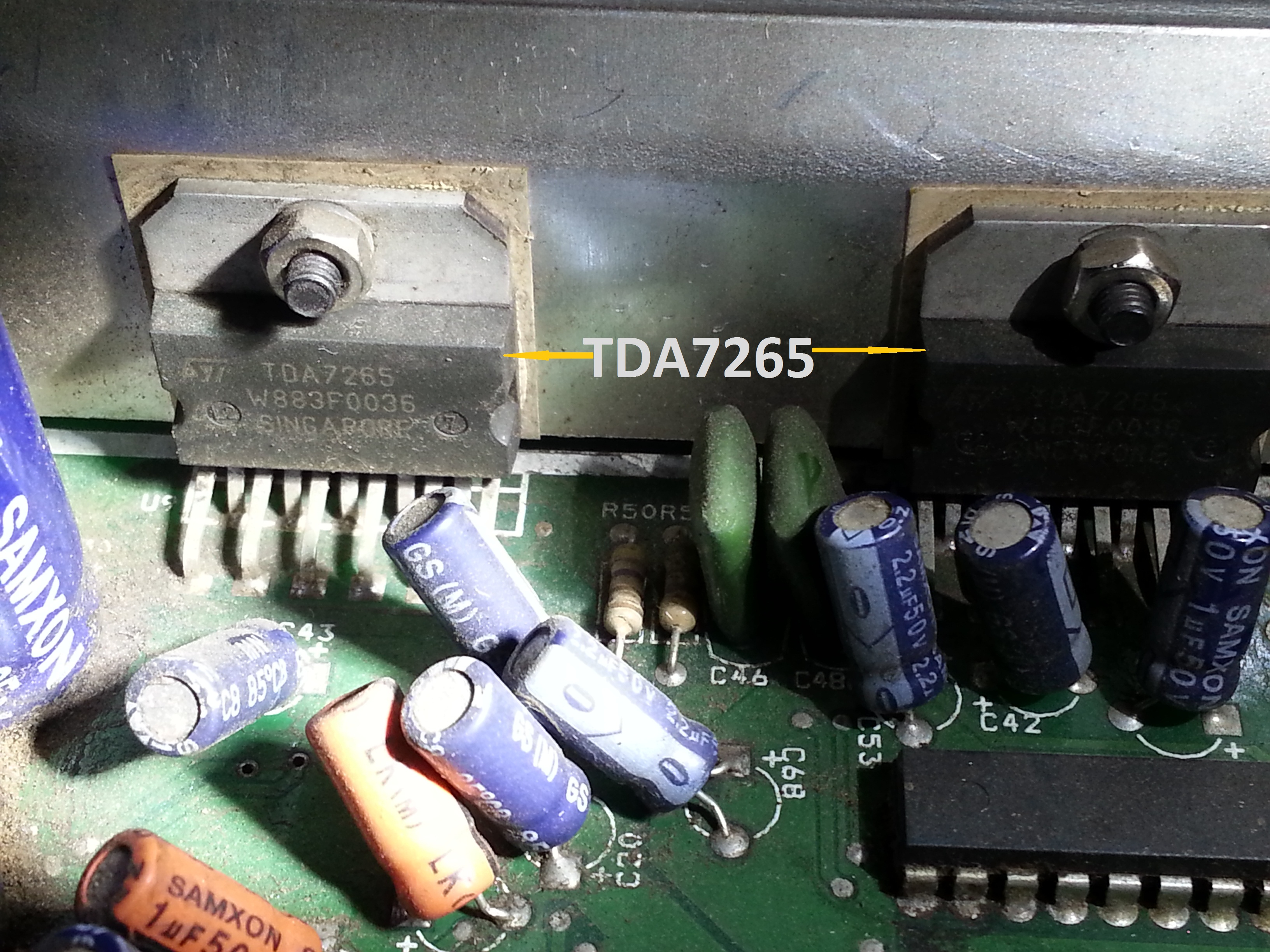

I have a pair of Altec Lansing ACS56 front speakers and another pair of Altec Lansing ACS54 rear speakers and an ACS56 sub woofer. When I connect any of the rear speaker to the front left port on the sub the sound output is much higher than the original port (rear left or rear right port). I know that the 54s has less output capacity then 56. There are TDA7265 amplifier which controls the output of the speaker(one for rear and another for front). So if changing the port can give higher output I believe it is the woofer which needs to be worked on. Besides, plugging in the left front to any of the rear speaker ports reduces the front left's output.
My question is how I can increase the output of the amplifier?
I am totally a novice to electronics. But I think if anybody can help I can work it out.:confused: Just give me detail instructions. Thanks

You are overloading the amplifier which might destroy it.
Each amplifier output is designed to drive only ONE speaker.
You cannot have more output power than it was designed for.

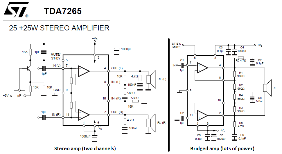

I am not familiar with the ACS56 but it is possible that the TDA7265 is being used in a bridge configuration (see Fig 17 of the datasheet), in which case it can drive only one speaker.

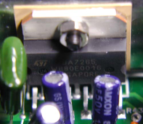

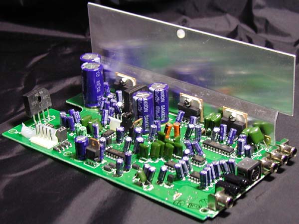

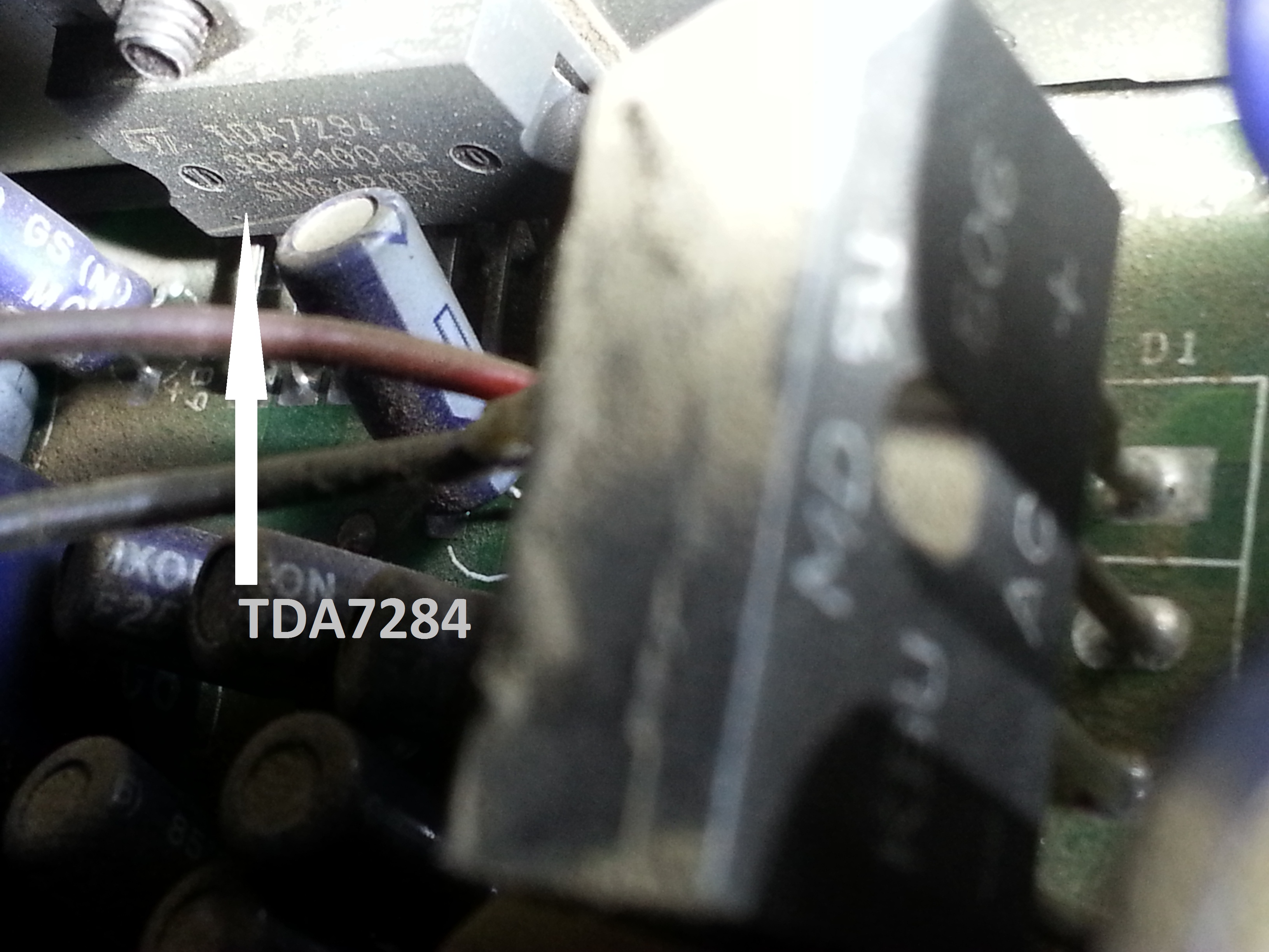

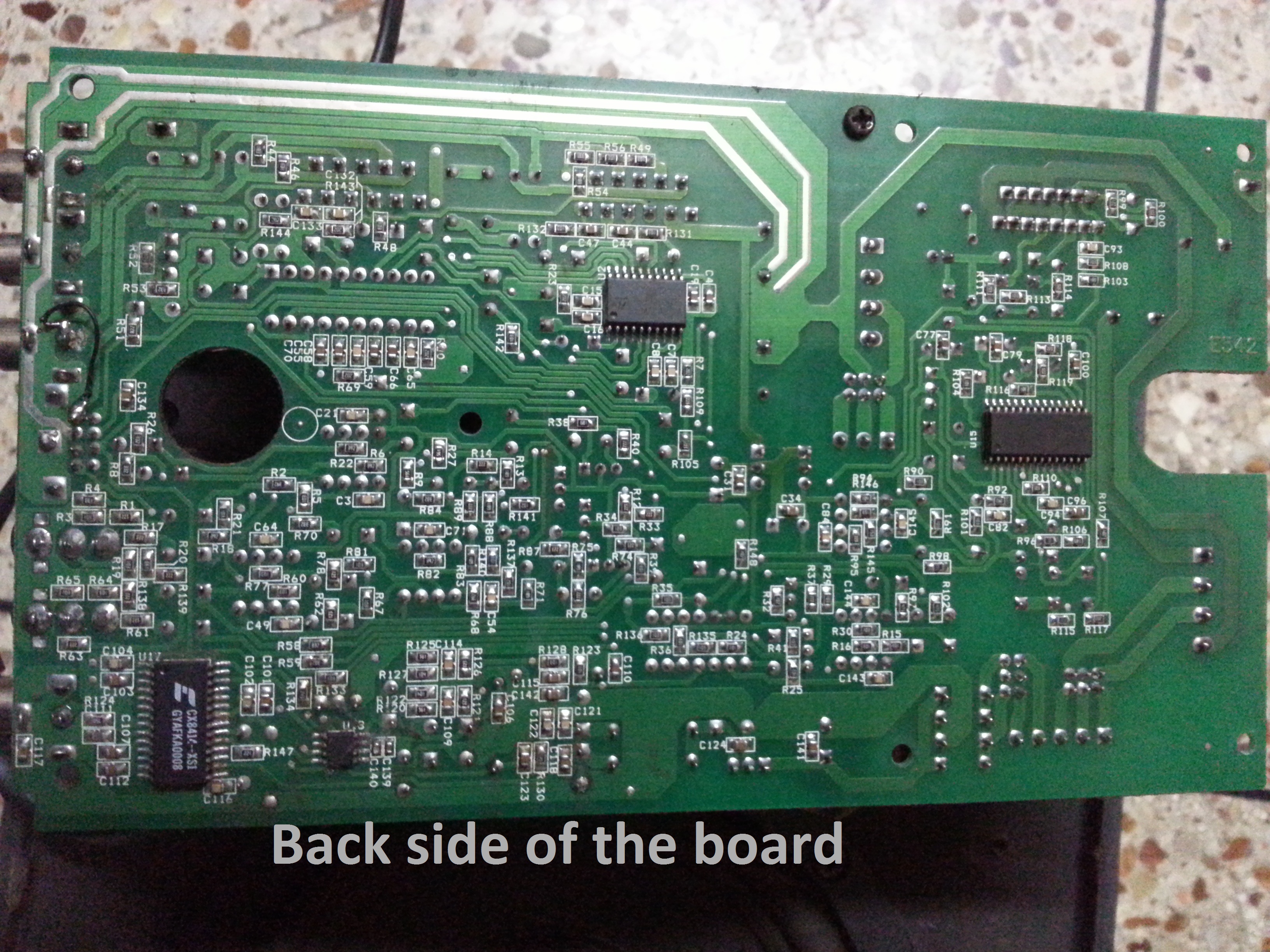

Hello guys,
So I am back again. I have taken some pictures of my sub's circuit board. Surprising enough there are only three amps. One TDA7284 (which is for the sub I think) and another two TDA7265s for the 4 speakers(each for each speaker pair).
But according to all of you it should be 1 amp for 1 speaker right? But I don't know what is really happening here. There suppose to be 6 amps ( if I am not wrong ), now whats going on?

Why don't you look at the datasheet of the TDA7265? It is a STEREO amp IC (stereo means TWO channels).
So two ICs are used for the four front and back satellite speakers and one IC has its two channels bridged for lots of power to the sub-woofer.

In your first answer you said "Each amplifier output is designed to drive only ONE speaker."
Am I missing anything?
Look back at the attachment AG has in post #7 and look at the section on the left, for stereo output.
How many inputs/outputs are there?
In the last answer you wrote "So two ICs are used for the four front and back satellite speakers". So each TDA7265 is for two speakers (front or rear or whatever).
One amp for the front pair, another amp for the rear pair, then another bridged for the woofer.
