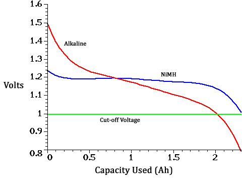

I've just got one question. Sopposing the alcaline batteries are down on voltage, and I then subject them to 3.05V, how are they going to react?
They're going to heat, vent gas, and possibly leak caustic compounds into the battery compartment with a slight possibility of fire.... 1.5V is nominal full charge for an alkaline... Please be aware of the use of the word nominal!

They will not react well. In lieu of repairing the regulation circuit, I would buy rechargeable Nicad AA's (or whatever the size is) and a separate charger for them from Radio Shack, or wherever, if the idea behind your contraption is to avoid having to constantly replace non-rechargeable alkaline batteries. The other option is to remove the batteries from the compartment and get a clean 3V DC power source to hook-in their place.
