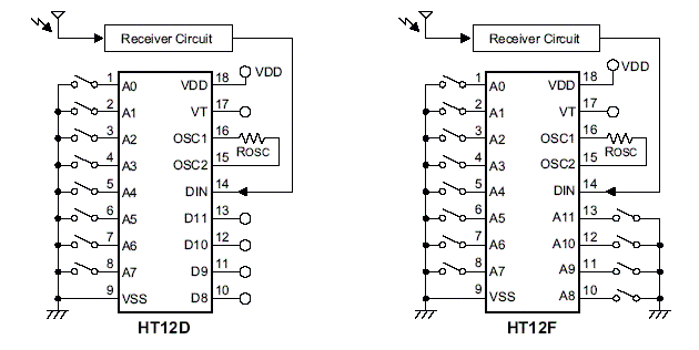

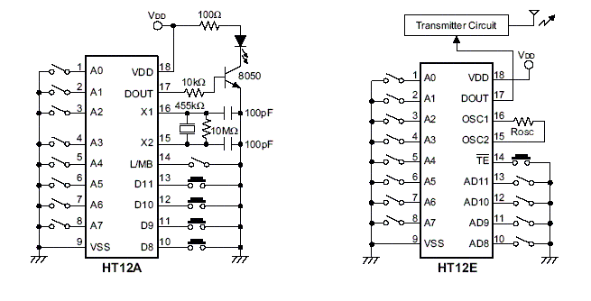

EDIT: Ive read through those data sheets more carefully and figured out much better how they work. Lemme run this by you to see if Ive got it right.
1. On the encoder and decoder, A0-A7 set the address.
2. On the encoder and decoder, A8-A11 are the output pins.
3.
Of the 2
12
series of decoders, the HT12F has no
data output pin but its VT pin can be used as a
momentary data output. The HT12D, on the
other hand, provides 4 latch type data pins
whose data remain unchanged until new data
are received.
I want the HT12A encoder and HT12F decoder because its data pins do not latch. Is that correct?
The circuits are application circuits btw.

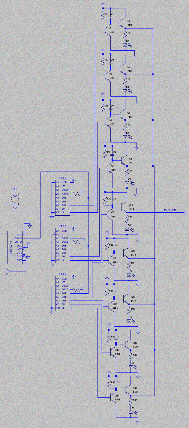

I did a bit more research and I think that the output of the HT12D is a positive signal. Assuming this, I have drawn up the receiver detector part of the schematic. You might have to save this to your computer and then enlarge it, too hard to see the writing.
On the output of each of these H212Ds, I have a circuit which will turn an LED on for a certain amount of time like 10 seconds, to show which system was triggered. It will also send a signal to the alarm for that same 10 seconds to turn it on.
I know that this is needlessly complicated and that there is a better way of doing it. That's where i need help please :lol:

Hi Zach,
Your PNP transistors are upside down. The collector of a PNP must be negative to its emitter. Then they need a base resistors or their forward-biased junction will be like a dead short when the NPN transistors turn on.
Depending on whether the receivers can provide enough current, the NPN transistors might be able to drive the LEDs alone, certainly if the NPN's were darlington. Then you won't need PNP transistors. :lol:
BTW, you need to add a diode from each LED driver to the alarm. The way it is now, if one LED turns on, they all turn on.
