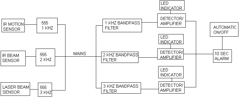

I made a block diagram of what my system will basically look like.

The usual method is to use a low frequency RF carrier, which is what X10 does - and all the other mains transmission systems (both audio and data) that I've seen.

Nigel is right on target. Search for X-10 information. I have seen many schematics on the rf to mains interconnections. X-10 transmission over mains is restricted to the mains Zero-crossing interval as that is the "quiet time" best suited for data transmission. Your simple system could also use DTMF based transceivers. This would keep a single frequency detection (noise) from falsely triggering an alarm, and allow a unique sensor ID to be employed by the transmitted DTMF digit .

I fail to see why?, haven't you ever seen mains borne intercom systems?, they transmit continuous audio via the mains.
1. The unwanted noise would have to be the right frequency (1khz, 2khz, or 3khz) in order to trip the alarm. Is that a legitimate concern? Or is it very unlikely?
For anything like this you don't want to just send a tone to trigger the alarm, you want digitally encoded data, which the receiver checks is the correct value to trigger the alarm.
2. DTMF is the dialtones on a phone, which is basically the same thing that I'm planning on doing: Sending audio tones through the mains. Why then should I use DTMF instead of audio tones generated by the 555? Using the 555 would allow me to have a unique alarm ID: alarm 1=1khz, alarm 2=2khz, alarm 3=3khz. I don't really care what the frequencies are btw, those are just examples.
DTMF frequencies are specially selected to not be harmonically related, random audio frequencies (or any audio frequencies at all!) aren't a reliable solution.
3. Is there any advantage in using RF frequencies instead of audio?
Yes, huge ones!, which is why it's done that way - probably the most important is that the mains wiring will represent a low impedance to your audio signals (shorting them out), it will represent a far higher imedance at low RF frequencies, allowing them to travel along the wires.

Check the MicroChip application note for X10 using PIC's, that gives a suitable interface for mains communication.
I just got finished looking at those application notes like you said Nigel, and wow, that looks rather complicated. Then i looked for prices, and they are about the same as 433mhz transmitters. I think I'm going to go with 433mhz transmitters actually because: 1. they are so much simpler, 2. because i dont have to mess with dangerous mains voltage 3. because as you all know, im fascinated with wireless and radio :lol:

Yes, home built projects usually use a transformer, the transformerless design is only for manufacturing cost reasons (cheapness!).
