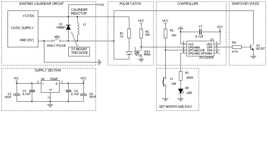

Hi markelectro,
Ok, there you are the most simple circuit i can suggest, keeping in mind its reliability.
In contrast of what it said previously, i took the freedom to modify the circuit of the calendar to simplify the electronic part.
Pulsing the inductor by the negative, the microcontroller can exciting this by a simple NPN (BC337).
The diode D1 is very important to short the high voltage produced when the swich turns off.
All other pulse switches existing must have one diode also. If not, the high voltage, can produce interferences on our PIC.

Hi marelectro,
Continuing from last post...
1. PULSE CATCH
The idea is, when the calendar inductor is powered by the electromechanic switch, the optocoupler put 0V (LOW) in the GP0 (PIN 7) of PIC.
So, the PIC read and count pulses.
2. SWITCH BY-PASS
When the calendar change from 30 to 31 in one 30 days month, the Q1 generate an additional pulse, as required.
But now the software knows that this pulse is "fake" and in fact it assume day 1 of next month.
For the Feb(28/9 days), it requires 3 or 2 additional pulses.
So, it would be funny if software knew to deal with the leap years. Anyway, this may be seen as one future ability.
3. SET MONTH AND DAY
To configure the PIC with one simple key, for two parameters, i use to do this:
a) Press and maintain the key down until Led flash twice.
b) Release the key and click n times according to the callendar day number.
For each click, the Led will blink one time to show valid CLICK.
c) When done, wait for timeout lets say 5 secs. When timeout is finished,
the Led will flash three times. This tell us that the system waits for month
setting.
d) Click the number of times acording to the number of month, JAN=1, FEB=2..
e) Forget the key and wait for the Led flash... 4 times.
f) After that, the software will save this settings inside of the internal eeprom and jumps to the RUN state.
4. SUPPLY SECTION
As you can see we have a 5V 78L05 (case=TO92), from the 12V main supply included in your clock/calendar system.This is required to supply the electronic section.
5. EXISTING CALENDAR CIRCUIT
Like i said in the last post, i don't know if the circuit is connected as i suggested or not, but if you do thus, our electronic circuit it becomes more simple.
The next post will be about software.

Hi markelectro,
Very beautifull mechanic pieces.
What i can see about callendar is just a collection of photos.
I can't find any coil current specifications. I suppose that at least 1A is enough?
If this is true, then BC337 must be replaced by one more powerfull.
The darlington BDX33C (case=TO220) is more than enough.
