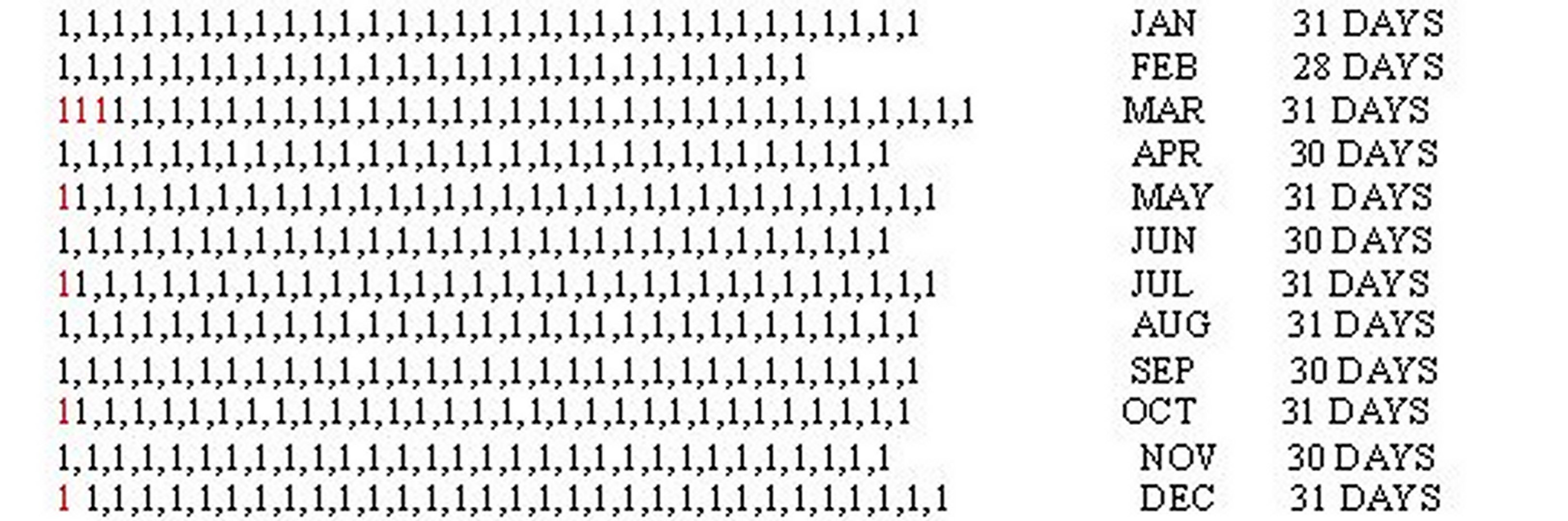

Hello everyone.
I am seeking advice on a little project I have in mind.I may find it a little hard to explain due to my lack of knowledge with PIC's but I will try my best.
The project I have in mind is to build a Mechanical and PIC.controlled calender clock/dial.
The calender clock dial will be run mostly from an Electro Mechanical impulsed movement that has a 31 toothed wheel (for max 31 days in a month)the movement is Electronically impulsed once every 24 hours so it is easy to get the calender dial to indicate the days up to 31.The hard bit is when the days of the month go to 28 or 30 now the wheel count can't do this.
My Idea was to have a PIC follow the natural flow of the electro movement and add on extra impulse only where required.

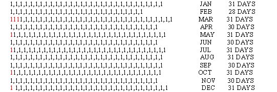

The chart in the attached file shows the months and the 1's are for the impulses required each day( 24 hrs) The red 1's show where the PIC will have to add a pulse so the count always adds to 31.(I hope you can read the file,I will email you it if you can't)
I think because the Calender clock receives an impulse to work the electro magnets that move the 31 toothed wheel a PIC. should be able to follow this pattern and could make adjustments where required.

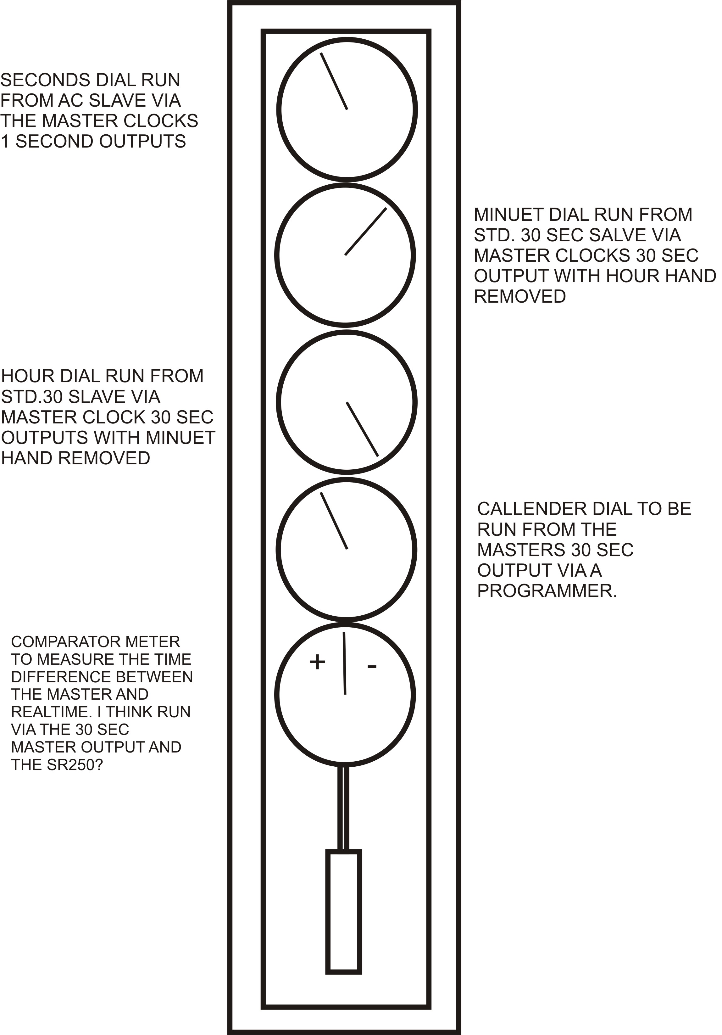

I opt for mechanics because the Calender is only part of a complete clock and this is 95% Mechanics so I want it to stay as much as poss that way.

Hi markelectro,
1st my apologizes for a little mistake when i refer 1 April, in fact the right is 1 March.
- Back to the original question, if i understand you right, your clock is already running, including day change pulses.
- You just need one circuit to add additional pulses in the months that have less than 31 days, right?
Imagining that you use one pic to do the job without leap year.
The pic must be syncronized with mechanics clock. I mean, the Day and Month in the Mechanic clock and in the Pic, must be the same.
This is because the pic must know in which months must generate additional pulses after follow (counting) the day change electro-mechanic pulses.
If this is what you want, i can help you writting a small piece of software to it and hardware design too, but just after you confirm this specifications to avoid working on something that serves to nothing.
Regards Jolino

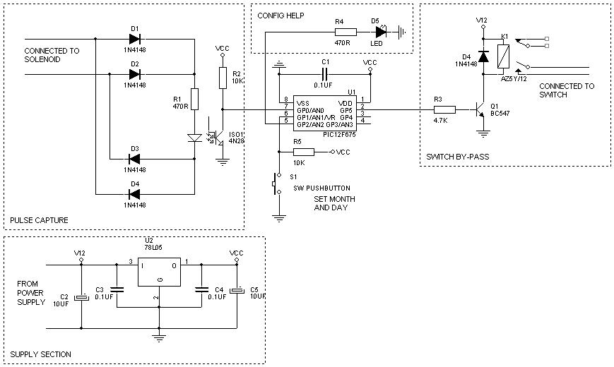

Hi markelectro,
the circuit principle can be like this, however it became more simple depending on the circuit that your clock have.

Just to ask if anyone could help with an alternative Schematic for my Calender project to the one using Pic?
I do realise that this would be the longer route but It my take me some time to get my head around the Pic programming required for the complete application,unless some kind member could give me an idiot's guide to getting this going.

Hi markelectro,
Very sorry, i have been very busy lately, so i don't see your message.
Back to the original question and after read all messages again...
The suggested circuit, can be more simplified if your supply will be DC.
If is the case, is important also know if the (-) is connected directly to one of the coil points and if the (+) connects to the other coil point, intercepted by the electro-mechanic switch (the one that generate the day pulse).
In this case we can remove the four 1N4148 and substitute the relay by two transistores (BC547&BC327) and a few resistors.
In the circuit, you can see one key and one Led.
This is need to tell the PIC in wich day and month is your callendar.
If you haven't this, the PIC it will never know when it must generate the appropriate pulses , right?
So, you can config this throught the key with the Led help.
I can tell you that i have a lot of circuits running like this.
Ok I do understand that the Pic does need to know where it is and where it should be,just how to get this I don't know!!.
jolino said:
Software:
Is no use to lose time before you decide if this is the solution or not.
I'm absolutely secure that this hardware will work.
When and if you decide about the electronic solution, then we can talk about software.
Great!! I will work from your advice and confidence that this will work,after all I am asking for help.I have burned a couple of PIC'S with suscess but it's the prgram that is difficult.
jolino said:
However i wait that you have trained some exercises in c that had certainly come with the tool that you acquired.
Again Jolino due to the fact I have very little knowledge of how parts of an electronic cuircuit work together I do see this as my forts project that will hop fully take me on to other projects.I do have the Tools to Flash PIC's and a little instruction on how to programme using C and ASMB. so again learning useful things along the way. Unfortunately in these early days I do have to have things explained in a idiots guide fastion,not like I'm an idiot but simple terms makes it sink in a little better.
Could you supply a revised drawing?? and if you can please explain what each part is doing!!!

Jolino just to give you a little insight of what I am trying to achieve I attach a little drawing of a clock I am designing.
The clock as I say is 12v although some of the slaves could run off a little less.
The Clock is a master clock with 30 and 1 sec pulses.
The clock consists of five dials-
dial 1- seconds dial (just showing seconds)
dial 2- minuet dial " "
dial 3- hour dial " "
dial 4- calender dial " "
dial 5- comparator meter
The seconds hour and minuet dials are easy for me to solve,the hour and minuets will run from the masters 30 sec output.The dials have std 30 sec slaves in them.
The Calender is where I require the help to get just right also the comparator dial I will have to think deeply about but this will be after the calender is solved.
Hope this help see where I finally want to be.
Regards Mark
