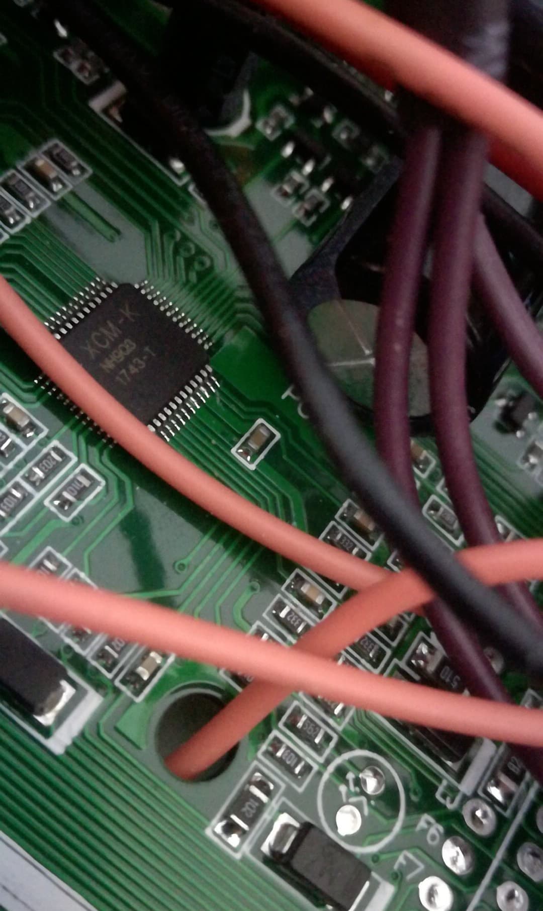

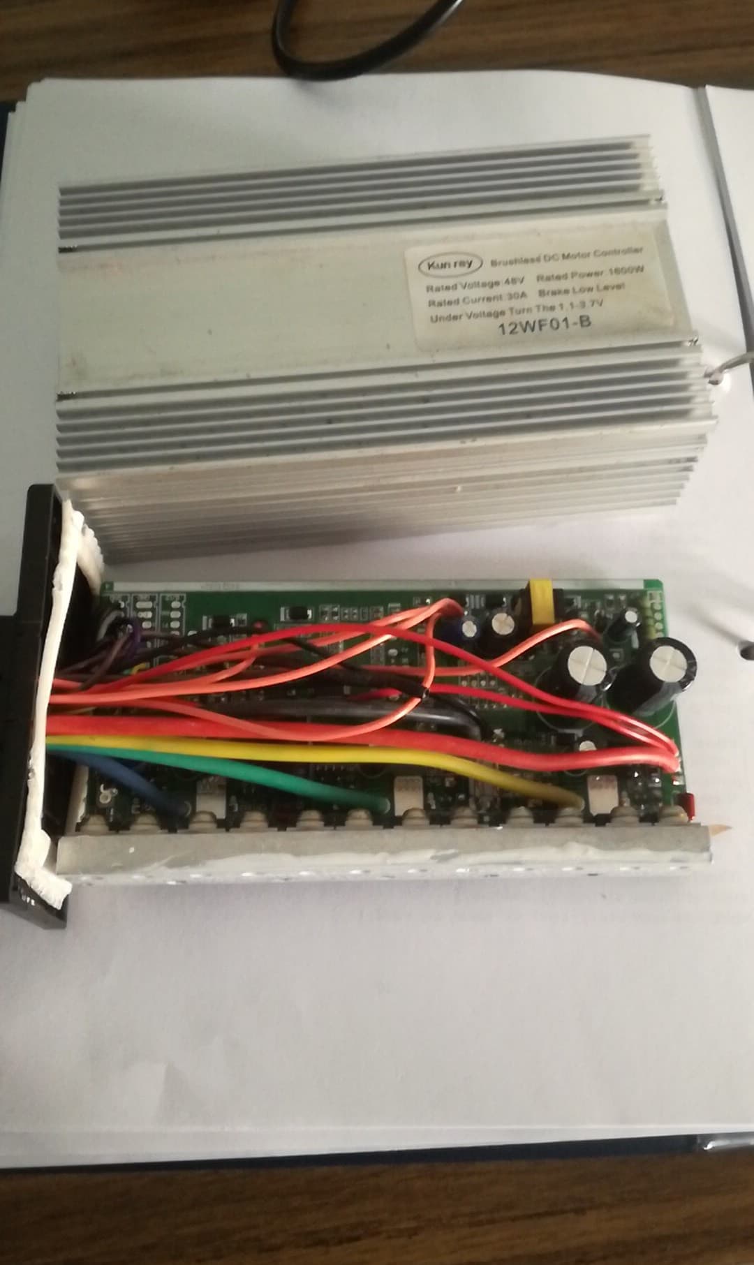

I made an electric cart. Therefore I bought a chinese 48v 1600W ESC, a 2000W 20Ah 48v lithium pack and a 48v 1600W bldc motor (and other electronics not related to my question).
The cart works well, but I would like to add the ability to drive in reverse. Therefore I see three 'options' to achieve this, being:

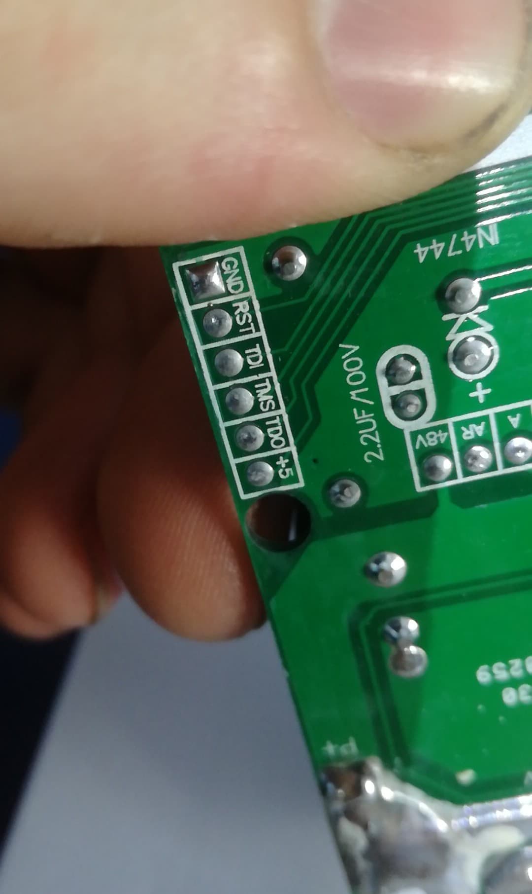

- Reprogram the microcontroller inside the esc (picture of µc attached)
difficulty: nothing to found about the microntroller so no original firmware found and no info on how to pogram it

- Use relays to twist a correct phase wire and the right hall sensors wires. (seems most achievable to me)
difficulty: making sure that the relays exactly switch at the same time so I don't creat a short. (using DPDT relays) + safety: making sure I don't apply full throttle forward and then full throttle backwards (I think it would make the motor generate power and that would kill the esc but i'm not sure about this).

Cross-wiring the corner tabs on a center-off DPDT switch is the most common way to reverse polarity and change motor direction. If you go online and seek out "DC motor control circuits", you'll see this and other solid-state designs using an H-ladder ( 2 or 4 opposing cross-connected transistors), and may include another switch to power up the control circuit.
Thank you Shokjok,
I will do it that way, changed my mind from achieving this with relays to doing it mechanically: ordered this drum switch :
Though I never saw anyone use it on a motor WITH hall sensors. But I guess I'll just have to mind switching those with another switch as well.
