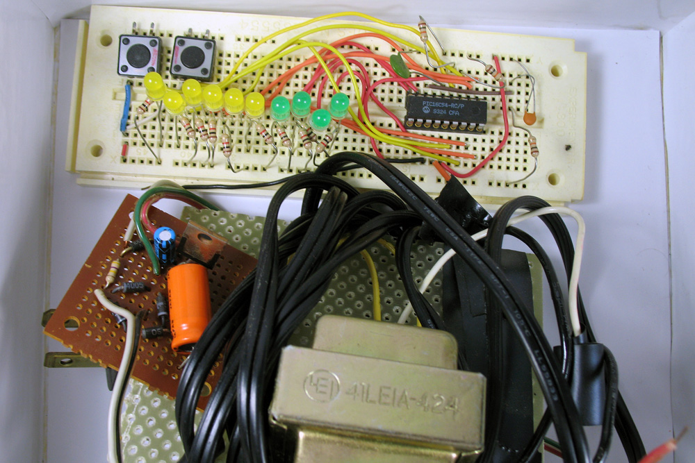

Among my many "weaknesses", is the lack of ability to actually package a project. I am fine getting a project on a breadboard....and I have a whole bunch of filled breadboards to prove that point. To illustrate, I went looking for a breadboard and found at least seven around here, all populated. To my surprise, I even found one of a binary clock (pictured below) using a PIC16C54. I have a folder with the hand-drawn schematic and a printed code listing...dated 19-JUL-1993! Worked like a charm...still on the breadboard....more than 25 years later. Apparently, I am waiting for this historical artifact to be discovered by future generations where archeologists will debate its cultural significance.
