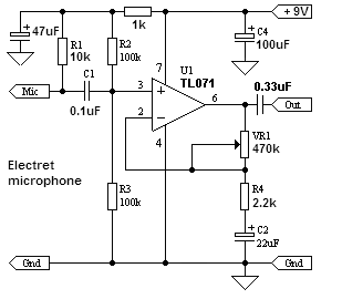

The 741 opamp circuit is inverting so it has a very low input resistance. You want a high input resistance so the opamp circuit should be non-inverting.
A 741 opamp is 46 or 47 years old and has too much hiss noise for a preamp. Also it works poorly above 9kHz but audio goes up to 20kHz so more than one octave of high audio sounds is missing.
Here is a preamp using a low noise audio opamp in a non-inverting circuit with a high enough input resistance. It works perfectly with very low distortion up to 100kHz, remove R1 that powers an electret mic:

Yes! That should solve his gain problem. Part of the battle.

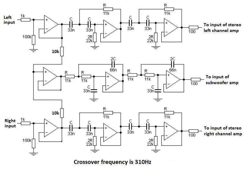

I have 18: sub in a almost 1m x 1m box. Is there a kind of crossover with the filter (adjustable would be handy) that i can use from the left / right amp output to my sub.
Stuart
You have a problem if you have a stereo amplifier but only one sub speaker. The sub needs to have its own mono amplifier because you cannot connect the left speaker and the right speaker outputs together to get mono for the sub.
You have another problem because you do not have a low level signal to feed the amplifier for the sub, then your stereo speakers will also play (and maybe get damaged) the very low and powerful sub frequencies. The stereo amplifier usually has highpass filters at its inputs.
I put together a crossover circuit that feeds the inputs of your three power amplifiers:
