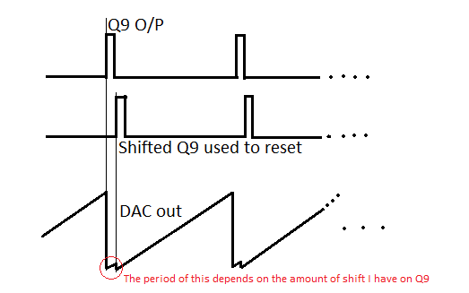

Came accross another issue down the line using this method of shifting the counter to higher bit number. I have a 10bit multiplying DAC connected to Q0-Q9 of 4040 to AD7533 to produce a ramp signal. When I am not doing any shifting to the reset signal, the ramp is clean, but as soon as I shift reset signal using 595 method, I see a notch in the ramp which I cna understand, but is there anyway to make this flat rather than looking like in the attachment?
thanks
