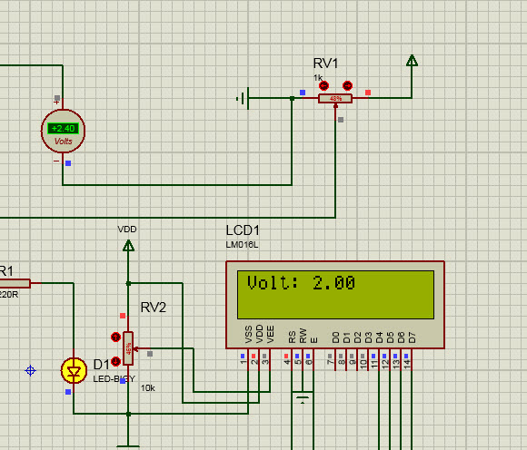

I am trying to send ADC value to LCD with PIC16F877A but only the first digit is displayed(picture attached). Can anybody help? here is the code:

Debug it, add the line v=123; after the line v = ((adc*5)/1023)*100; //eg v=234 and then you'll know where the error is. It could be the ADC reading or the displaying.

hi Pommie,
thanks, when v =123 is added the digits are displayed correctly.
i have tried debug but couldn't figure out how to get the variables window in proteus.
so what we know is that v = ((adc*5)/1023)*100; is creating the problem. I tried by changing the data type of v but not working. I think the conversion eqn. is ok.
could you perhaps give more insight??
I'm just a braindead Basic programmer but won't this equation be done in integer math?
Try rearranging it to:
v = ((adc*5*100)/1023)
(adc*5)/1023 will only evaluate to one digit in integer math.
The maths needs to be done in a 32 bit variable as ADC*5*100 can be over half a million and a 16 bit integer can only hold 65535 maximum.
Try making v a long and do the maths 1 bit at a time,
unsigned long v;
    v=(long)adc;
    v*=500L;              //may not need the L at the end
    v/=1024L;
Note, see thread on why it should be 1024.
Edit, added cast to long.
