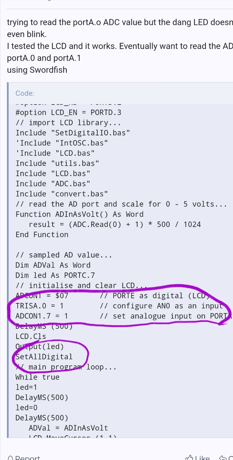

trying to read the portA.o ADC value but the dang LED doesn't even blink.
I tested the LCD and it works. Eventually want to read the ADC on portA.0 and portA.1
using Swordfish
Device=18f43k22
Clock = 8            '8MHz
'Config FOSC = INTIO7   'internal oscillator
#option LCD_DATA = PORTD.4
#option LCD_RS = PORTD.2
#option LCD_EN = PORTD.3
// import LCD library...
Include "SetDigitalIO.bas"
'Include "IntOSC.bas"
'Include "LCD.bas"
Include "utils.bas"
Include "LCD.bas"
Include "ADC.bas"
Include "convert.bas"
// read the AD port and scale for 0 - 5 volts...
Function ADInAsVolt() As Word
   result = (ADC.Read(0) + 1) * 500 / 1024
End Function
// sampled AD value...
Dim ADVal As Word
Dim led As PORTC.7
// initialise and clear LCD...
ADCON1 = $07       // PORTE as digital (LCD)
TRISA.0 = 1        // configure AN0 as an input
ADCON1.7 = 1       // set analogue input on PORTA.0
DelayMS (500)
LCD.Cls
Output(led)
SetAllDigital
// main program loop...
While true
led=1
DelayMS(500)
led=0
DelayMS(500)
   ADVal = ADInAsVolt
   LCD.MoveCursor (1,1)
   LCD.Write("DC Volts = ", DecToStr(ADVal / 100), ".", DecToStr(ADVal, 2), " ")
   DelayMS(2500)
Wend
The words all have meanings, and this has been explained to you before.
What does the first circled area do?
What does the second circled area do?

the circled area got put in by mistake from SAMPLE ADC CODE
my working code doesn't have porte it was an oversite
the circled area sets the ports up for adc input. I think the ADC.bas sets all the registers.

¤ What does SETALLDIGITAL do and why is this necessary?
This is a simple question, yet essential for programming.
¤ What do the TRIS and ADCON statements in the first circle do?
Again, simple question and the answer is in the remarks.
¤ What happens to whatever the TRIS and ADCON accomplish when followed by SETALLDIGITAL?
If you can answer the first two questions, this will be easy to figure out.
Your problem is an extremely simple troubleshooting exercise that should have taken 30 seconds to spot. This isn't a complex problem; it's something that should be easy to recognize and fix.

Here's where copy-paste has gotten you into trouble all over again.
All pic's aren't the same, so what you did/copied for one device may not work for another.
You need to actually read the datasheet for the part you're using, or at least
check that the register settings you have in your code match up to the chip.
For example, here are some comments for what you had:
Device=18F43K22
// THIS DOES NOT SET "PORTE as digital (LCD)"
// ADCON1 selects the positive and negative reference for the ADC
// THIS IS TRUE
// THIS DOES NOT "set analogue input on PORTA.0"
// IT SELECTS THE SPECIAL TRIGGER FROM CTMU
DelayMS (500)
LCD.Cls
Output(led)
// IF THE ABOVE HAD DONE WHAT YOU WANTED, IT WAS TO NO AVAIL
// SINCE CALLING "SetAllDigital" NOW WILL WIPE OUT MOST/ALL THE ABOVE SETTINGS
SetAllDigital
And here's the real mind-blower... you don't have to set a pin's analog/digital mode to use the ADC.
As long as the pin is an input (use the INPUT statement) you can convert it.
You really only need to set a pin to analog mode to disable the digital input buffer which will not be happy with analog voltages at its input.
You DO, however have to set the "digital" pins to "digital mode" since they all power up as analog by default, and a pin in analog mode will always read as a '0' to the digital input.
Since all of that is probably gibberish, here are some tips
- use SetAllDigital at the beginning or your program, before you start doing anything else.
there is a subroutine called SetAnalogPort in the file SetDigitalIO.bas that you can use after that to set the one or two pins you want to use
with the ADC back to analog mode. That way you won't have to figure out the difference between how this works for all the different chips.
- use 'output' and 'input' statements and skip using the TRISx registers
- don't set a register when you have no idea what it does
Here's an example which sets all pins to digital except for RA0
device =18F43K22
include "setdigitalio.bas"
SetAllDigital
input(PORTA.0)
SetAnalogPort(AN0, ANA)
// rest of your code...

MrDEB !!!! Before Jon pops a gasket..
SETALLDIGITAL .... SET ALL pins to DIGITAL..... Thus turns off the ADC to every pin.... To turn on individual ADC pins either use the ADCON reg's , or the newer chips, the ANSEL reg's
Actually, just to clarify, all of this analog/digital mode stuff never disables the ADC inputs...
it just enables or disables the digital input buffer, which is disabled by default for any pins that have analog capability.
It doesn't prevent you from reading an input pin with the ADC, even of the pin is set for "digital mode".
What it DOES screw with is the ability to read the pin normally.
When a pin is set for analog mode (which remember, is the default) its digital input buffer is disabled and it will ALWAYS read as a logic '0'.
That's why it's important to set the pin mode early in the startup sequence.
If a pin is going to be used for analog voltages (ie ADC, comparators, etc) it's a good idea to set it to analog mode.
That way the digital input buffer won't see invalid digital levels. For example, if a digital input sees 1.5V it's neither a valid high or a low.
This can cause the input buffer to oscillate and increase current consumption, which is never a good idea.
That's why they have the chip default to analog mode (which causes everyone to cuss and b*tch).
