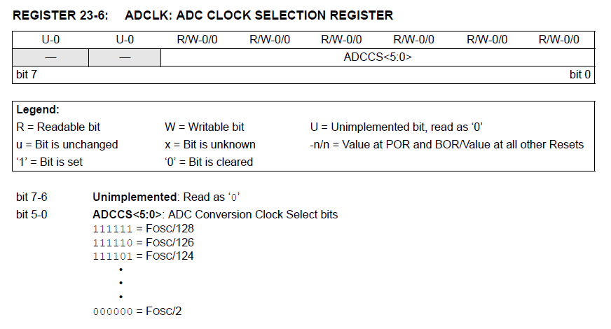

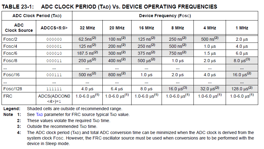

I'm using one of the newer Pic16 series chips and the ADC has become a lot more complex. However, the writers of the datasheet seem to have gotten lazy. In this table they've skipped a lot of rows (I think),
The way I'm reading the above is that 1.0uS is a good period for TAD. I'm running at 32MHz and assume that there's a missing row of Fosc/32 where my time will be 1uS.
To further confuse the matter, the register where you set this value seems to have a typo,
Surely those (divisor) values should be halving each row and Fosc/124 is a typo and should be Fosc/32?
Is there another document that describes this?
Thanks for any comment.
I don't see anything wrong with the table. The divide ratio is 2 * (ASCCS<5:0> + 1)
The 6 bits of ASCCS<5:0> read as a binary number in the range 0 - 63
Adding one gives 1 - 64
Multiplying by 2 gives 2 - 128
If you want to divide by 32, ASCCS<5:0> should be 15 or 001111
You are, of course, correct. Guess I got confused due to the top table going in binary steps and assumed the bottom table was a typo. Morning here now, let's see if a clearer head helps me to get this working.
