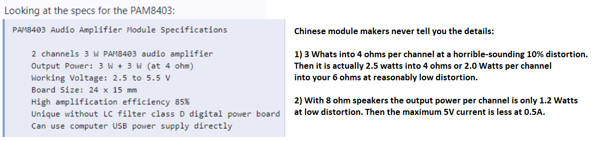

Looking at the specs for the PAM8403:
PAM8403 Audio Amplifier Module Specifications
    2 channels 3 W PAM8403 audio amplifier
    Output Power: 3 W + 3 W (at 4 ohm)
    Working Voltage: 2.5 to 5.5 V
    Board Size: 24 x 15 mm
    High amplification efficiency 85%
    Unique without LC filter class D digital power board
    Can use computer USB power supply directly
That last line makes it sound ideal for my needs; but I assume that to get the 6+ Watts of power, they must mean a USB 3.x; not the USB 2.0 available from the monitor?
I have a coupe of spare USB 3.x sockets on the PC; not as convenient, but doable.
You and the sales people did not read the datasheet of the PAM8403:
A Chinese module with a real (not copy) PAM8403 in it is cheap. Get one and try it. You might find that it is not loud enough.
Then find one that produces 30 Whats or 20 low distorting Watts per channel which will sound twice as loud as the 2 Watts per channel.
Twice the power sounds only a little louder since the sensitivity of our hearing is logarithmic. 10 times the power sounds twice as loud.
