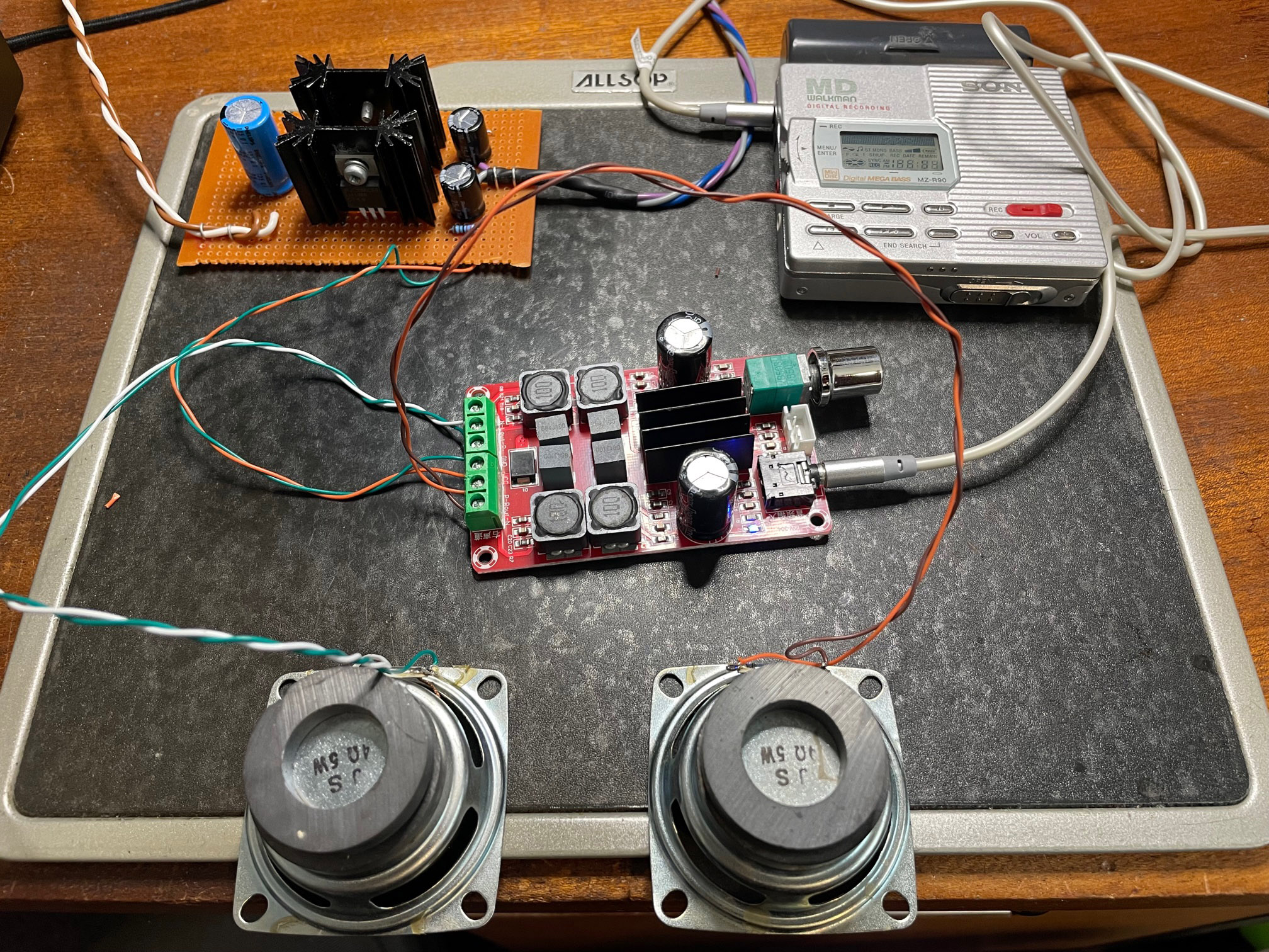

It appears the PAM series ICs are just about all there is for high efficiency amplifiers 5V operation. There are many sellers on amazon & ebay etc. [Correction - see below].
For the cost, it may be worth trying one to see of it works OK and the quality & volume are acceptable; theoretically you could get near 1W per speaker, which should be OK for desktop use.
The amp modules are very cheap it's a simple experiment to do a lashup test, and the only real way to really know if one is suitable for your needs.

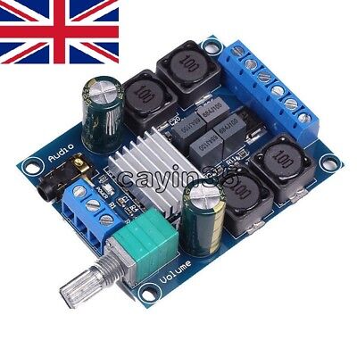

I've built an amp for my PC but using higher power amp modules based on the TPA3116 D2 IC; I've used quite a few different amp modules containing those, from ebay, and never had any problems. Some run my whole-house audio system.
You do need a separate power supply if you use these, though; 12V or higher (up to 24V.) [No, again see below].
These are examples of common boards I've got; there are loads, from numerous suppliers.
(I have three of the first style in the PC amp, plus a separate surround audio control PCB; a bank of the second style are in the house audio, after modding to directly access the balanced input on the amp IC).
The second one claims to work down to under 5V; I never noticed that before, but I was not looking for low voltage ones.
I've just tried a spare module at 5V from a little test rig regulator, and it is surprisingly good - enough volume to be annoyingly loud with speakers close to you, I've not got it near full for a comfortable level.
The little reg board uses linear regulators and has a 12V supply in to it, so at half an amp it would be dissipating around 3.5W of heat (and rather warm). It is staying stone cold, so the amp operating current is quite low.
The only small speakers I have to hand are a couple of tiny bare ones ripped from some scrapped cheap PC speakers years ago; it's a bit tinny like this, too much treble & not enough bass - but I think it would be fine with the speaker in suitable enclosures.
(The old minidisc player was the only thing I could think of to get a 3.5mm audio source next to the other parts).
It's good enough to leave on for background music while continuing to type !
[The MD player had the Deep Purple "Under The Gun" album in it when I dug it out].

I've ordered the PAM 8610 board I linked above -- I like the idea of the class D design. I'll try it with the USB 3.1 sourced from the PC back panel and see if the ~4W output suffices.
If not, I've a few DC adapters I can try: 5VDC@2A; 15VDC@200mA; 12VDC@4A. Once I've settled on what I need I'll probably look to buying a dedicated board and wrapping the whole lot up in some sort of enclosure.

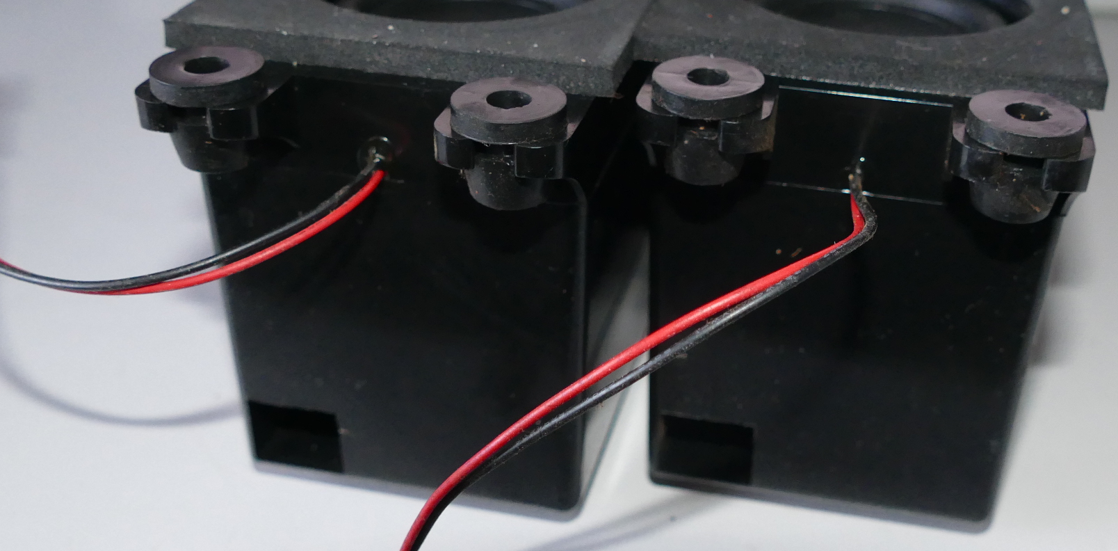

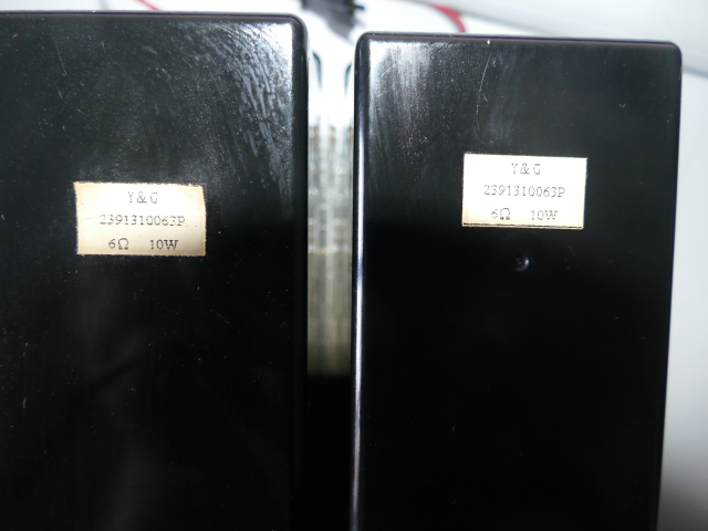

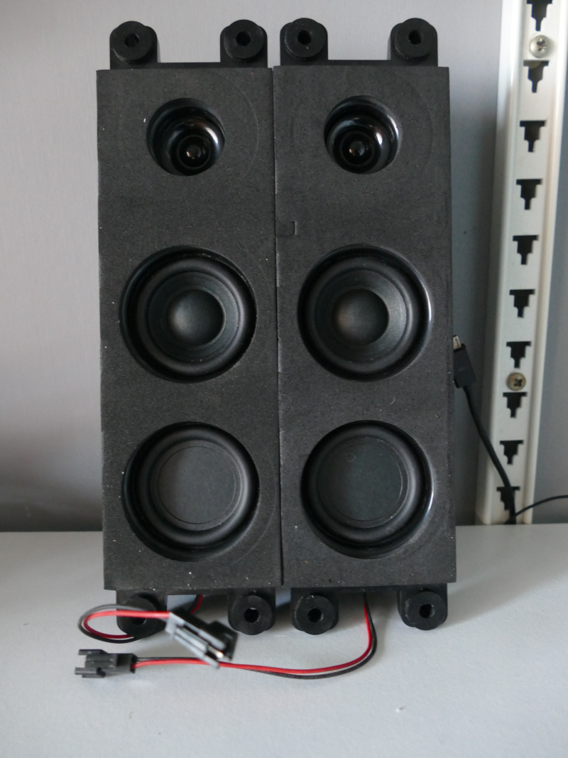

The speakers I have are labelled as 10W/6Ω, have 3 speakers each and look like this:
I assume that they use passive crossover, but as they are welded units, there is no way to look inside without ruinning them. They have reflex output holes on the bottom:
According to my elementary understanding, if you feed 5V into 6Ω; I=5v/6Ω = 5/6; W = 5*5/6 = 25/6= 4.166W.
The amp claim 90% efficiency, so 4.1667*0.9 = 3.75 to the speakers and say 50% sound and 50% heat, a bit under 2W of audio per channel. which is all I had from my old monitors built-in speakers and it was perfectly adequate for my simple needs.

Your entire premise is wrong I'm afraid - you're confusing resistance and impedance, and DC and AC.
The speakers also don't seem to be 6 ohm (impedance), as you measured them as 8 ohm (resistance) - generally (and in the many of hundreds I've measured over the years) an 8 ohm speaker reads around 6 ohms resistance, and a 4 ohm one around 3 ohms - basically DC resistance (with a meter) is normally about 3/4 of the impedance. Impedance is a funny thing anyway, and isn't far off a 'guess' as it varies by frequency.
With a 5V supply the maximum AC output voltage can only be 5V p-p (peak to peak), this calculates as only 1.77V RMS, which gives about 0.5W to a 6 ohm speaker. Assuming the amplifier is bridged, this effectively gives twice the voltage, increasing power to 2W. This assumes zero losses, and you obviously won't get 5V p-p off a 5V supply, there are always losses, and double the losses if using a bridged amplifier.
Hm. That puzzled me. I cannot see why speakers built by or for a TV manufacturer for installation in their TVs, would be incorrectly labelled.
So I dug out the clamp meter I use for household stuff, put new batteries in and tested again. This time I get a reading of 5 ohms. (This meter doesn't do decimal places.) Then I checked the 9V battery in my multimeter and it flickers between 4v and 5v. Ie. its dead! I don't have a replacement to hand.
I also suspect that there are some passive components inside, as the resistance drops slowly after the initial connection from ~8 down to 5ohms over a couple of seconds.
Like I said, you can't measure them using a meter, as that just measures DC resistance, and in fact you can't measure them accurately anyway as there's no accurate value possible - the specified figure is just a rough estimate.
But no one wants the figure on the speaker to read "varies between 3 ohms and 67.5 ohms".
The datasheet for the PAM8610 amplifier IC says the minimum supply is 7V. If you use a 12V supply then the amplifier will produce 10W per stereo channel into your 6 ohm speakers at fairly low distortion.
Understood, but my confusion was why my resistance reading was greater than the marked impedance rather than less as you -- and other sources -- pointed out it should be. The low battery explained it.

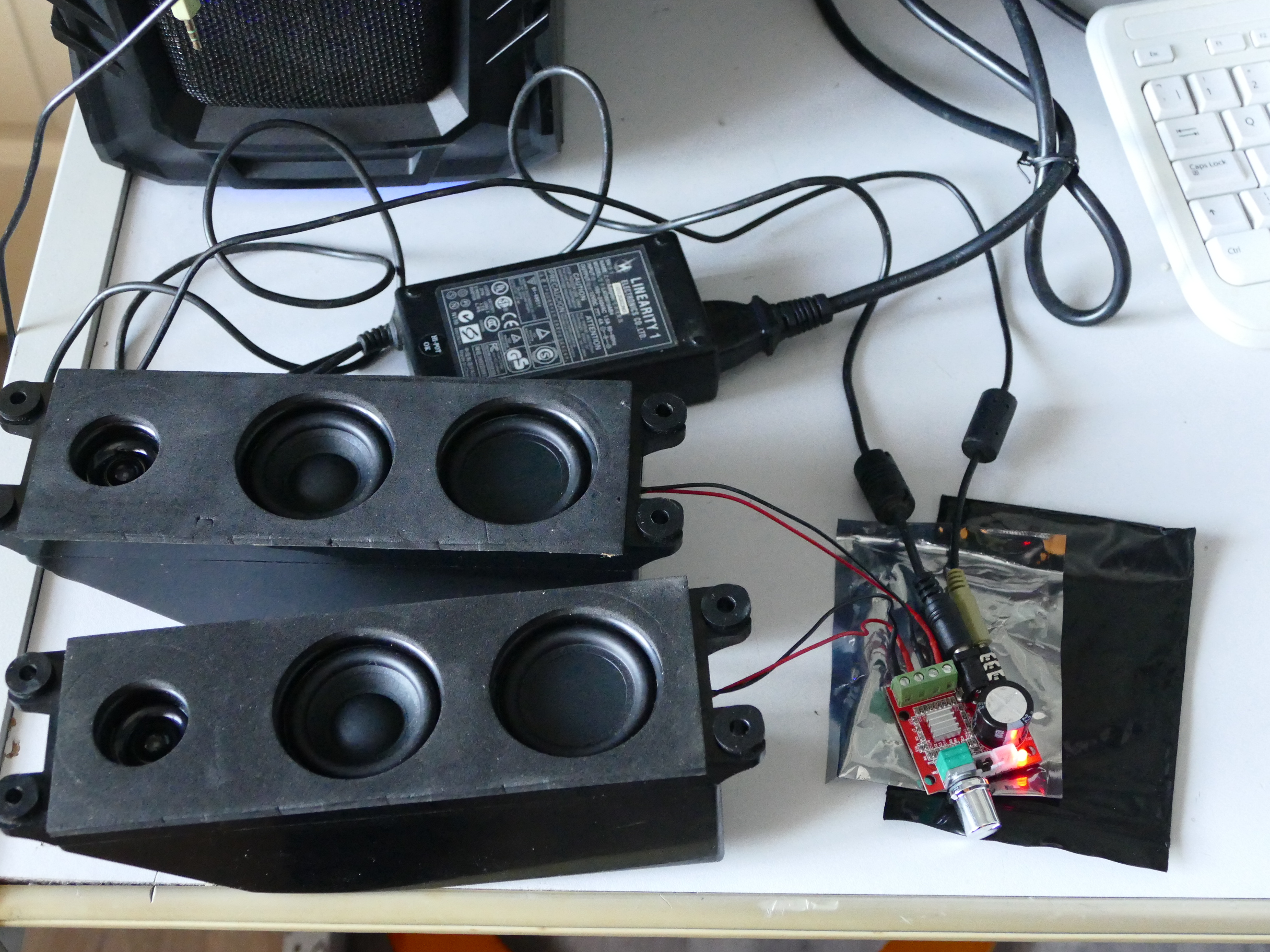

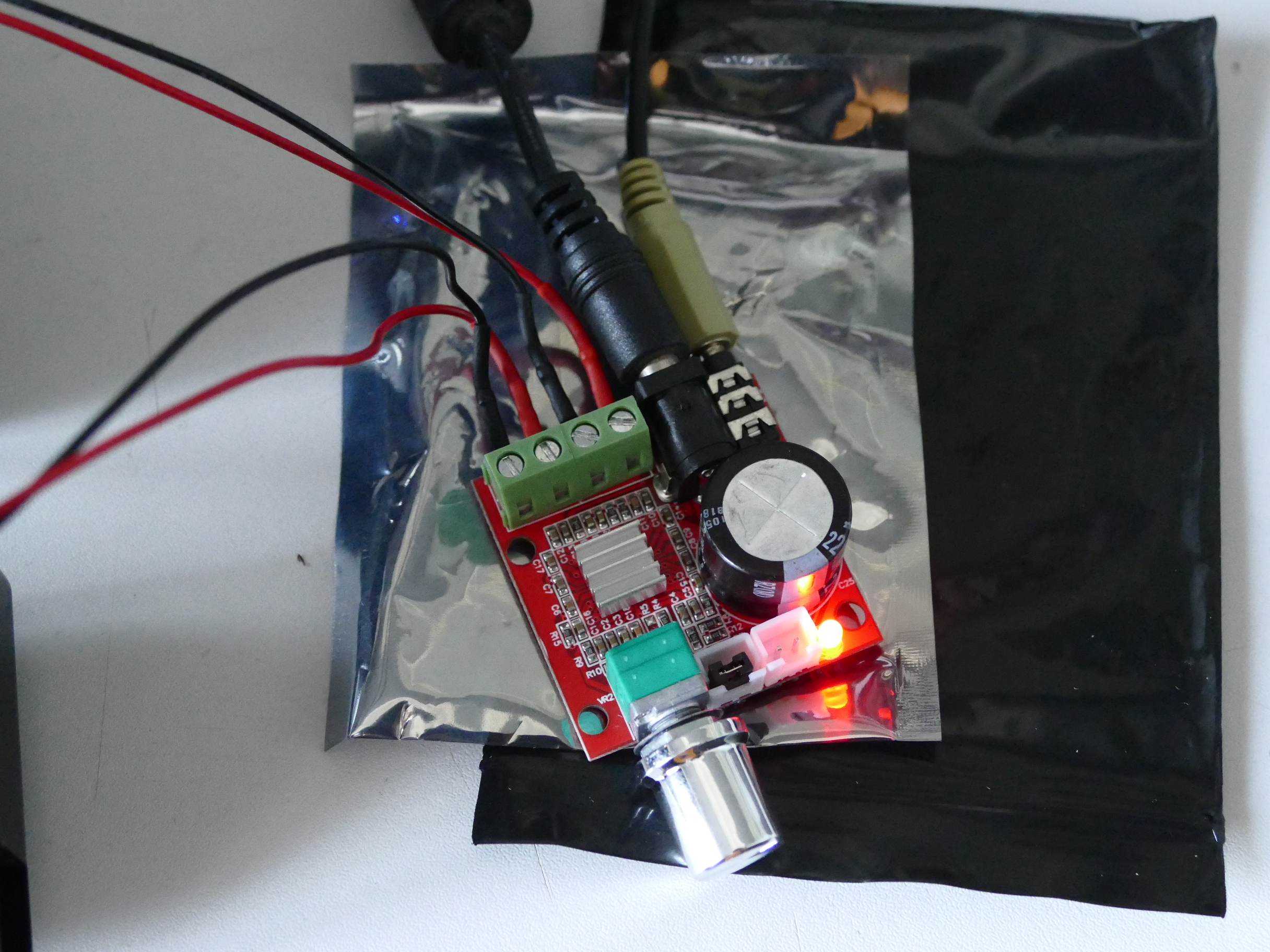

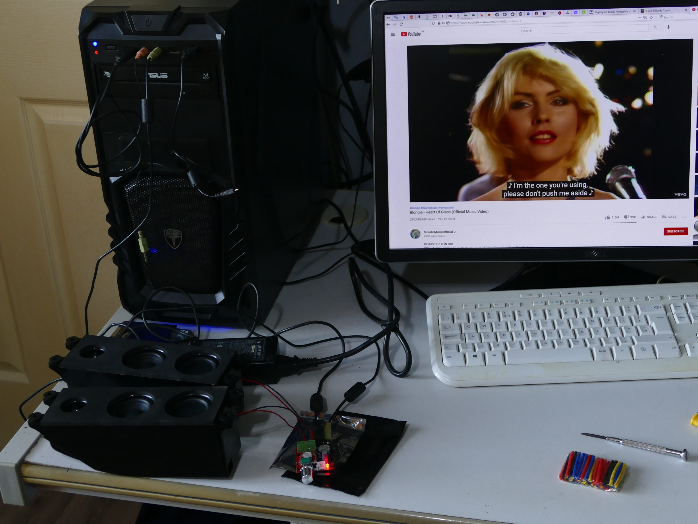

In case anyone is interested. It lives:
And the verdict is good, the base on the Blondie track at half volume made the keys on my keyboard rattle; and the clarity of the crystal notes on this video
frankly astonished me. (Not a a HiFI buff!)
It is a little noisy as is when nothing is playing -- but this room is full of emi, Hopefully it'll improve once I get it into a grounded enclosure of some kind. For now, I'll dig out some switches and connect up the mute & off buttons.
Thanks for the help guys.
